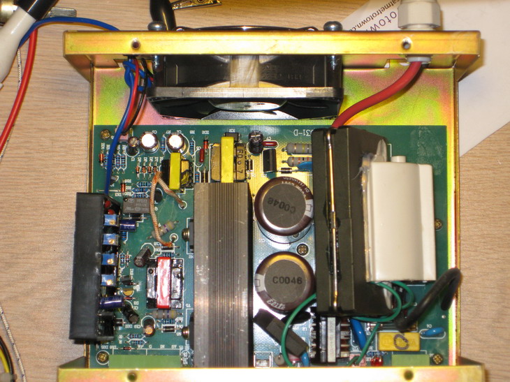

PS inside : Looks exactly like ps from :
http://www.ebay.com/itm/40-WATT-HIGH-EF ... 3cc01c0eb0
It works correct without ppi or with low ppi values like 50
There is a problem with 500 and higher ....

Do you think pwm setting can be involved ?
I think it is a supply problem not a tube
After problematic ppi job supply is not able even a fire tube.
After some time supply regenerate and everything looks fine.
It doesn ´t look like a input circuit problem more like a part of circuit aroud a high voltage and transformer.
