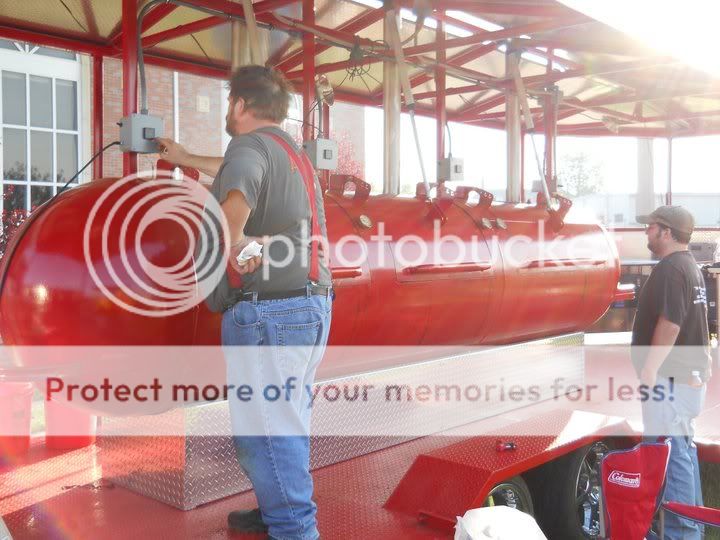

HERE YOU GO BOYS !!
this is just a littel note on how i worked around this problem for smoker or cooker
take the air flow that you think or worked out that you need and then dived it in half then buy 2 fans that size .
stager j1 and j2 like 10* so set point 250 j1 on 240 off 245 j2 on 235 off 240 so both fans are on till you get close to set point and then
j2 goes off then j1 slows to set point and it j1 can kept temp if knot the j2 kicks in to help
cory
Re: JLD-612 for Charcoal Smoker Temperature control
You sure this thing won't blow?! It look like to me that it's a 'nuke'
Anyway, I'm glad that it work out and thank you for the support from Rich!
