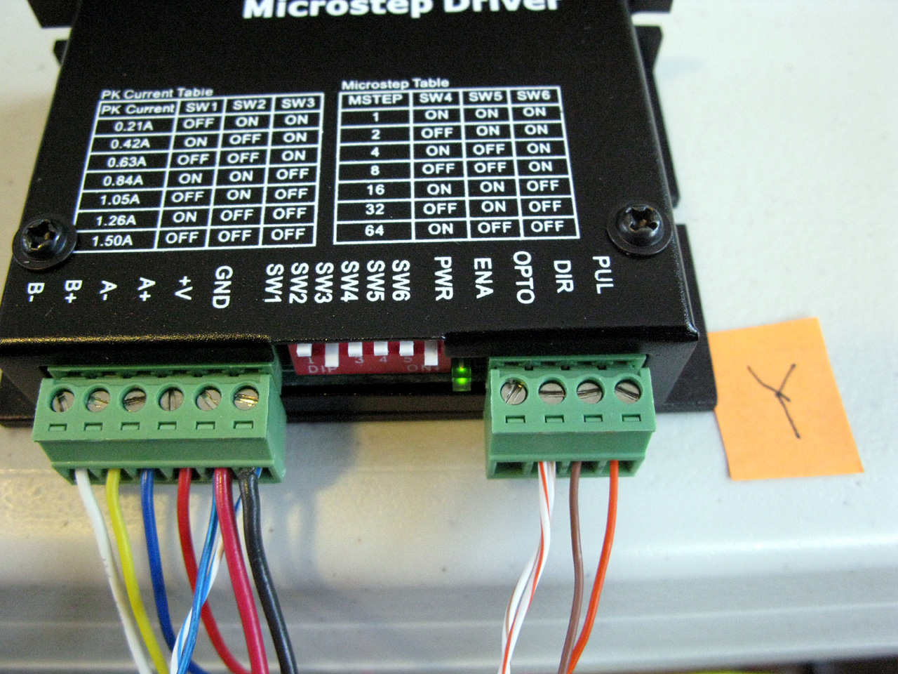

Got my P650 drivers today, yay!
Now to the wiring ... inputs are :
PULL
DIR
OPTO
ENA
How to match with the DSP's pins ?
DIR
PUL
DC 5V (-- to ENA or OPTO ??)

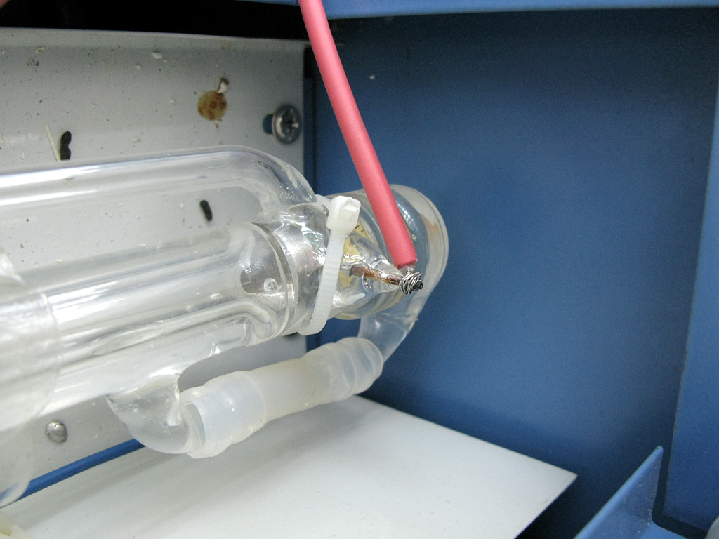

Other question : should the high voltage wires be soldered to the laser tube ? I cant find that info nowhere...
thanks
PULL
DIR
OPTO
ENA
DIR
PUL
thanks

Start with the PUL -> PULL and DIR -> DIR. You probably don't have to use the Opto or Enable lines at all. Leave the 5v open, as well. Just the two lines should make it works.Lumifab wrote:Got my P650 drivers today, yay!

Tube connections NOOOOOOOOOOOOOOOOOOOOOO. Don't solder. Too easy to crack the glass from the heat.
- 1 Strip bare some wire on end of lines from PS.
- 2 Wrap the bare wire as tightly as possible around the connections.
- 3 (Optional) I strapped the insulated portion of the wire to the glass tube with wire ties to keep everything from moving.
- 4 Take an additional piece of bare, solid, wire and tightly wrap it around the connections as well.
- 5 Use hot glue to completely cover the exposed wire connection.
- 6 After that cools completely, use some high voltage silicon tape and wrap the connections to insulate from possible spark jumping to laser frame.

I"ll setup the 2M415 (not P650) today and will post the connection after I completed the test
See picture for the CO2 connection. Please follow Tim's advise, do NOT use soldering iron trying to connect the HV wilre. It's a big mistake if do so!

Connecting DSP with 2M415
Attached pictures are showing the connection of 2M415 stepping motor to a DSP controller.
Pay attention to the color of wires, especailly the Blue/White for the power. Don't be confused with the power. I should use Red/Black but I didn't have wires handy so I used the Cat-5 cable
The connection is pretty straight forward: PUL to PUL and DIR to DIR
The confuse part is hte "OPTO". Just connect it to the +5V from the DSP main board will take care it
