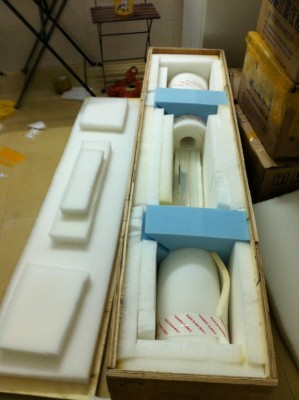

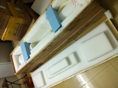

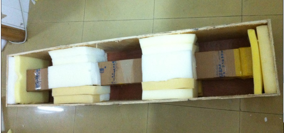

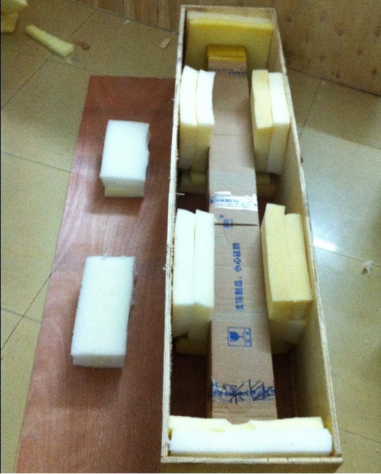

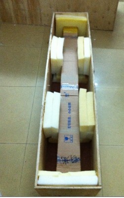

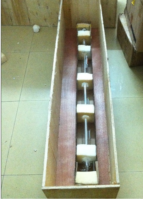

Two months ago we had four tubes cracked by 'who know' during shipment. They cracked 1x Reci 80W, Reci 130W, 1x 60W, and a doa 60W. So, we decided to do change shipping method and go for double packing. We special ordered a wood case and use it to contain the the original packing of the tube with 4~5cm sponge in between the wood case and the inside box. To do it, the carton box should be good enough to abort vibration from a drop of the shipment.
We just shipped out a Raci 150W to Germany, Reci 130W to Indian, Raci 100W to Irvin, CA, 80W to Texas, 60W to Mexico
in last couple days. Wait to see if the packing provide 100% free of cracking!
