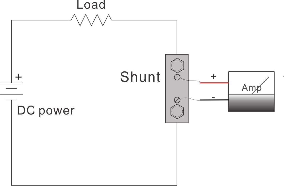

Basic connection of a DC amp meter with a shunt
The rating of the shunt should match the rating of the amp meter
Most amp meter take 75mV DC shunt.So, if you have an amp meter say 30A, 75mV, then you need a 30A,75mV DC shunt to work it
See picture
