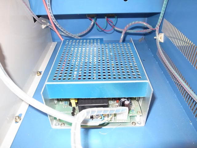

here i have posted electronic guts of my 40W laser.
looking to upgrade the sticky moshi stuff.
i hear some OEM power supply units can work with the 2012-DSP controller smoothly without the need to upgrade the power supply unit, i wonder if this is one of them.
could anyone identify these for me?

Hmm. Is there another power supply in there? You need a 24v power supply in addition to the laser power supply to drive the DSP and steppers.
I can't comment on the laser power supply as I don't have that one.

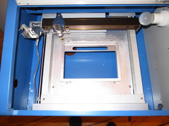

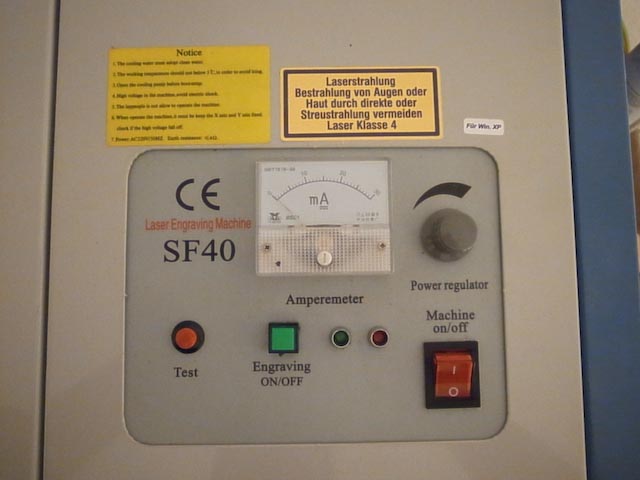

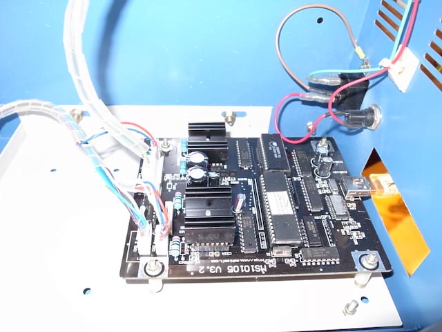

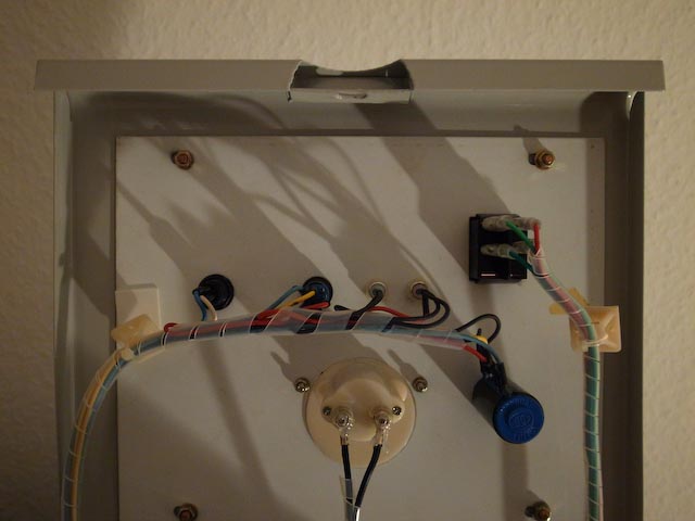

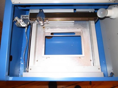

Hi
you should post a picture of the whole interior of the machine and maby the underside of the display that we can identify what you have

His machine is not the same as you guys have. There are many manufacturers in China are making similiar machines (K40) with the same case. Even though it looks 90% similiar, but the inside guts may not the same.
1) The Laser PS I can tell is from another party in ShangDong provience name "MingYue". I used to use his PS but stop using after their quality control was in doubt. The 130W PS always have leaking "jump fire". This PS should have DC24V & 5V power build in so that he doesn't need a separated power supply for the Moshi board.
2) The Laser power supply doesn't need the "giant green monster" (resistor) as it's better than what the K40 used to have with ShenHui own PS.
3) The PS is analog typ and it works OK with the DSP card but the result may not as good as the PWM. I was told that gray scale of an anlogy ps may not result as clear as PWM does. However, the overall result will be times and times better than the Moshi (the junk)
