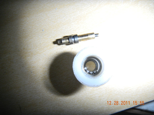

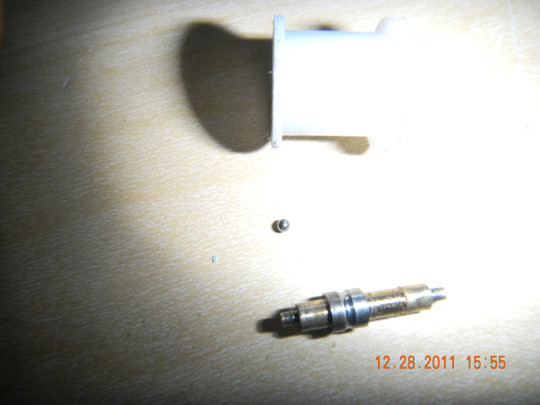

does somebody know where I can get a tensionier for the Y axis belt of a 40W chinese CO2 laser.
after I have allready repaired one side of my Y axis drive becaue the tensionier did have only 1 bearing in it and this brought up a dramatic wobble .
see pic thats what I discovered today that the engraving showed more and more lines and by checking the left site Y belt it was totally loose and there it was the same like on the other site but worth because the bearing was allready apart.
now I am feed up with this cheap roller tensionier and I would like to buy the brass version but can not find it.
if somebody knows where I can get it or even a original please let me know

Hi marco
I only got one more picture attached, it is the tension wheel for the Y axis there are two and for the X axis is one. but all the original seems to have onlu one ball bearing what is stupid on such a wide wheel of 0.65 inches. bard from buildlog has some but they are only for 1/4 inch belts the K40 Y belts are 3/8 inch and the axel is 5mm wher the origional is only 2mm.
I fixed mine with two ball bearings each .
happy new year to you
