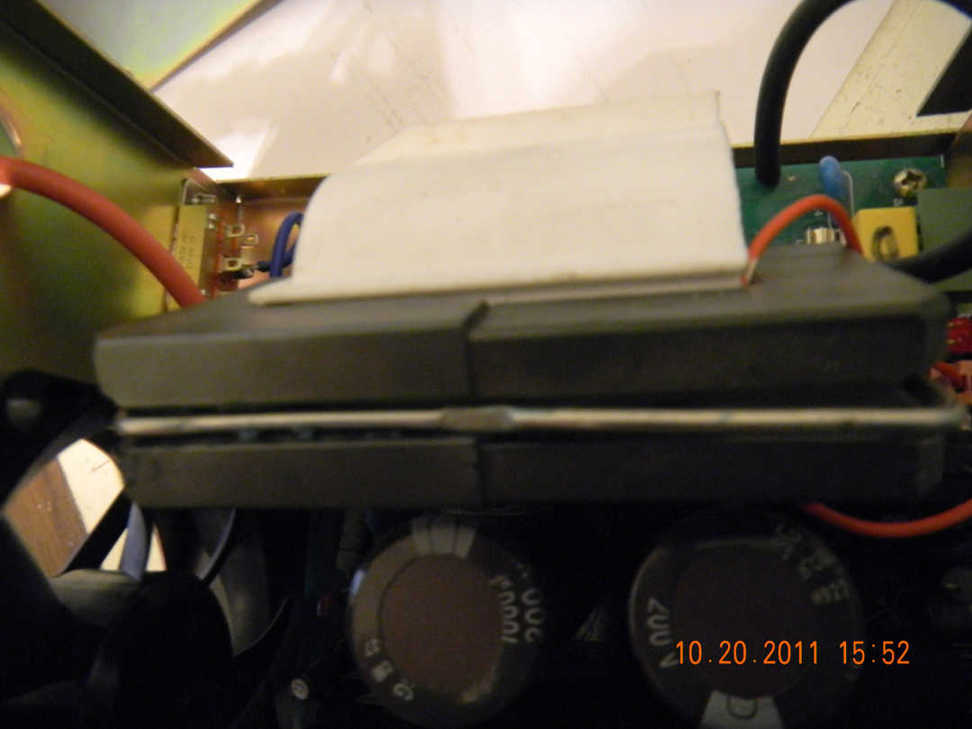

I opened the HV supply in order to move the HV wire away from the rear to put the fan directly to the outside of the machine. then I discoverd that the wire can not be disconectet from the HV transformer or the coupling. does anybody know how to do this??
the next thing was that the HV transformer has two different size halfs of the core what is not good see picture attached
maybe marco can comment on this also to marco ca you not make the HV wire 4 inches longer then this would be long enough for all K40 laser and you could save the coupling.
I will post picture after installing the HV supply
two different size half of the core

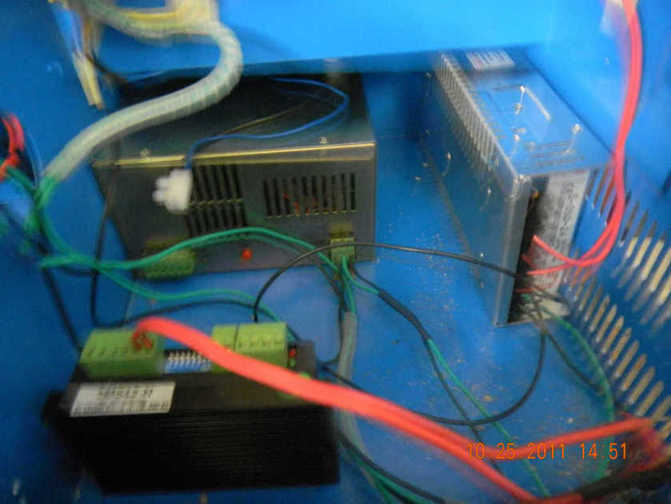

after changing the HV power supply ( see picture ) I mounted in the laser body. I had to cut out a opening for the fan because my machine did not have one I have seen some who had allready one ( lucky you),
then I mounted the fan on the out side of the poer supply and then in the machine boddy ( see the other picture)
then I cut the HV wire connector away what did give me the right length to direct conect to the laser tupe.
this way I dont have the useless extension. that should probably be changed on futhure power supply.
LIke you see I mounted the supply on the left hand side because I will mount the 24V power supply on the right hand side right on the perforated outside this safes me to cutout another opening.
with this mounting the whole inside will not be heatet with the heat outflow of the air from the 2 fans and the whole inside will be over the airstrom cooled.
I also change the position of the water hoses to a higher part this way the hoses dont run on the bottom of the machine now it runs in the hight for a water resorvouir

I did connect the 24V power supply and drilled holes in the outside of the machine for the cooling fan of the 24V power supply.

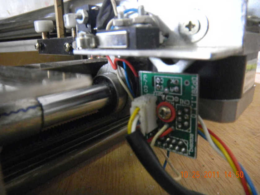

also I installed the two limit switches and use the existing PCB board took out the original switch parts and soldered the wire from the new switches to it this way I can use the original ribbon.
the DSP and panel worked at the first time perfect.
the next step will be the connection of the motor driver and the limit switches and maybe I am lucky and this works too.
