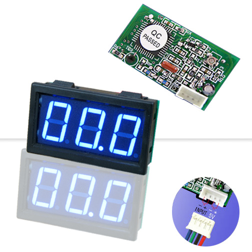

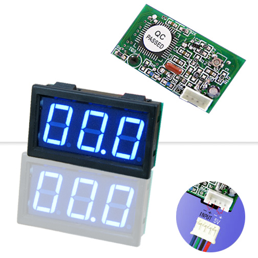

Oh! almost forgot to mention that we add a Blue Color digital current indicator with faster sampling (others are slow) to monitor the laser current. It will looks good! I'll post the image here very soon. Cheers!
