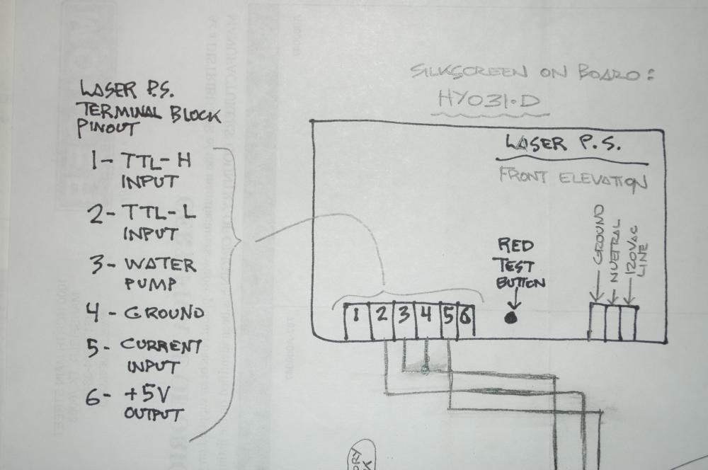

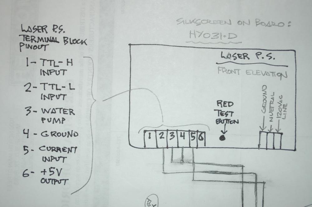

Here's the wiring connections:
DSP Laser 1 terminal block Laser PS terminal block
1 -------------------------------------------------- 3 and 4 3 is water pump, 4 is ground
2
3 -------------------------------------------------- 2 2 is TTL-L input
4 -------------------------------------------------- 5 5 is control input
5
6
Ground is connected to 24 volt negative switching PS, and equipment/case ground, which up here means earth ground/water pipe.potential.
Maybe I should just change out the laser PS and be done with it. I don't know what to get.

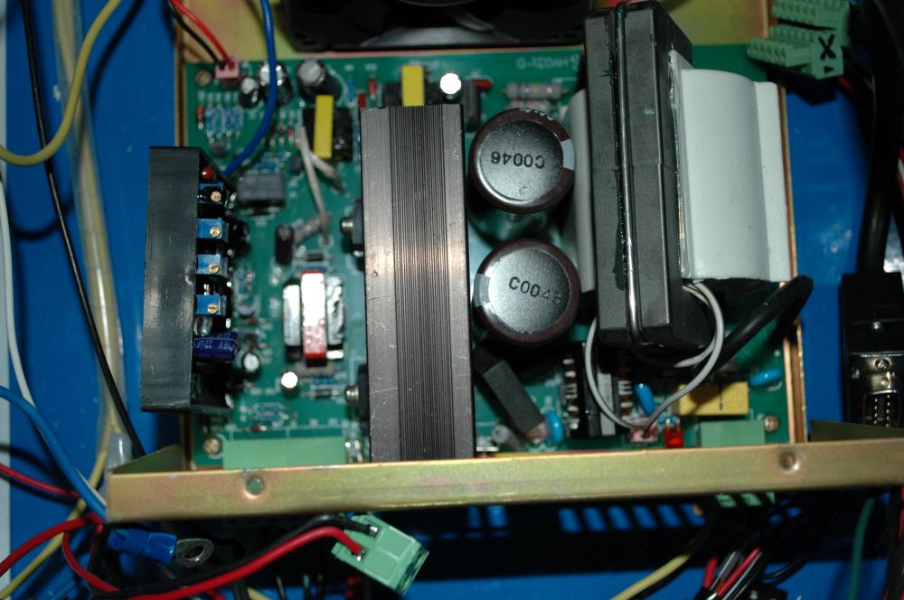

here's the Power Supply pictures. The dimensions of PS in picture 4917 are:
3.75" high x 6.625" wide x 5.75" deep
cheers,
Denis
cheers,
Denis

Your power supply seems is PWM ready. Now you should give a try by using PWM on the DSP card. Simply cap #2,#3 for J4 or J5.
Plus, you shouldn't use the original power control (the potentialmeter) and let the DSP to do the job. You didn't post the control part so I don't know how you control the power so far.
If you can, you may want to open the case of the power supply and take a picture for it as I want to know what PS you have
You're getting closed as now your X,Y motion is doing well, so just be patience and hold on and you will get it!

I will draw a picture of the wiring connections between DSP and PS and send the picture.
I've enclosed several pictures of the PS and the 50 watt wirewound resistor has been relocated on to the rear panel in the fan airstream # 4959, # 4963
Several PS pictures are # 4962, 4961, 4964
Wiriing diagram between DSP and PS is # 4966, 4967, 4968.

I don't see any problem of your connection diagram above. It looks good to me. Which wire was shorted? Are you now using #2 (TH) to enable the Power supply? If so, it means that the either the PS's TL or the DSP TL (level low) has an issue
Anyway, the hardest part has past and the alignment adjustment is considered much easier than anything else.
