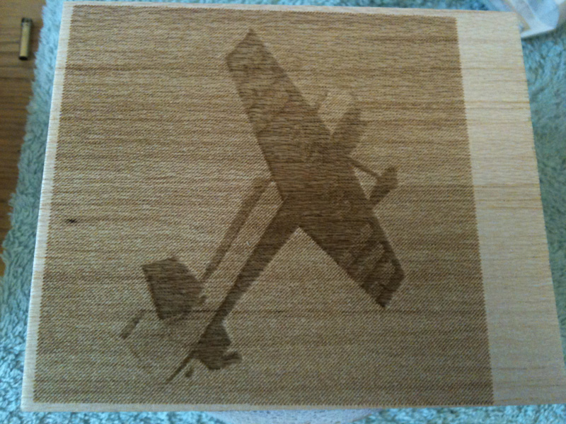

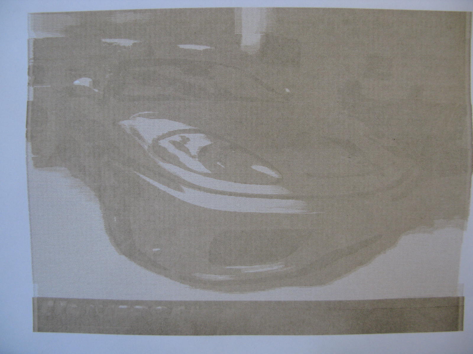

Update (8-4-2011):
Found a new problem by boosting the T-H to 5V. The output file seems more 'flat' See attached images. I think the 5V push the power supply in 'satuated' mode. I'm going to try 4.6V later
Cutting is good as it now can cut 3mm epoxy glass without a problem.

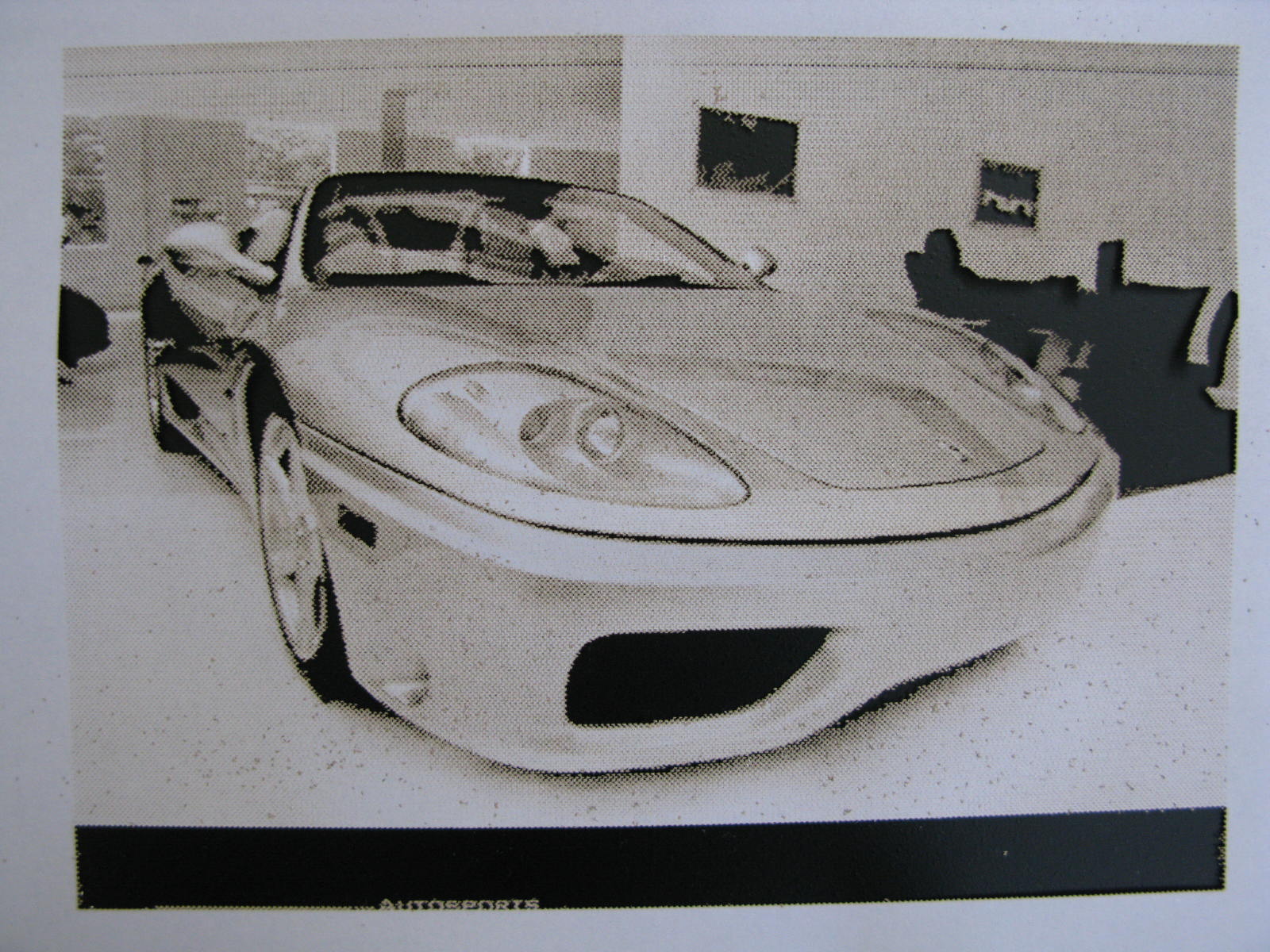

Updat(8-4-2011, evening):
Found a solution. I dropped the 5V booster module. Then, adjust the power output control on the power supply to 19mA max. With the Analog circuitry that I installed on yesterday, actually it worked as it used different output signal patten to control the fire. The "TH" singal is not a constant 5V but variable, as opposite to a PWM power supply to which the TL always 5V (or closed).
See attaced images (a little bit over burned as I keep changing the power)

Looking good marcoTech_Marco wrote:Updat(8-4-2011, evening):
i try burn little balsa
Try to burn it on a pieces of paper and if can send me the picture file and let me try it. Then I can tell if yours if properly setup. Did you use do 'dittching' on the image, if so what is the dot size?

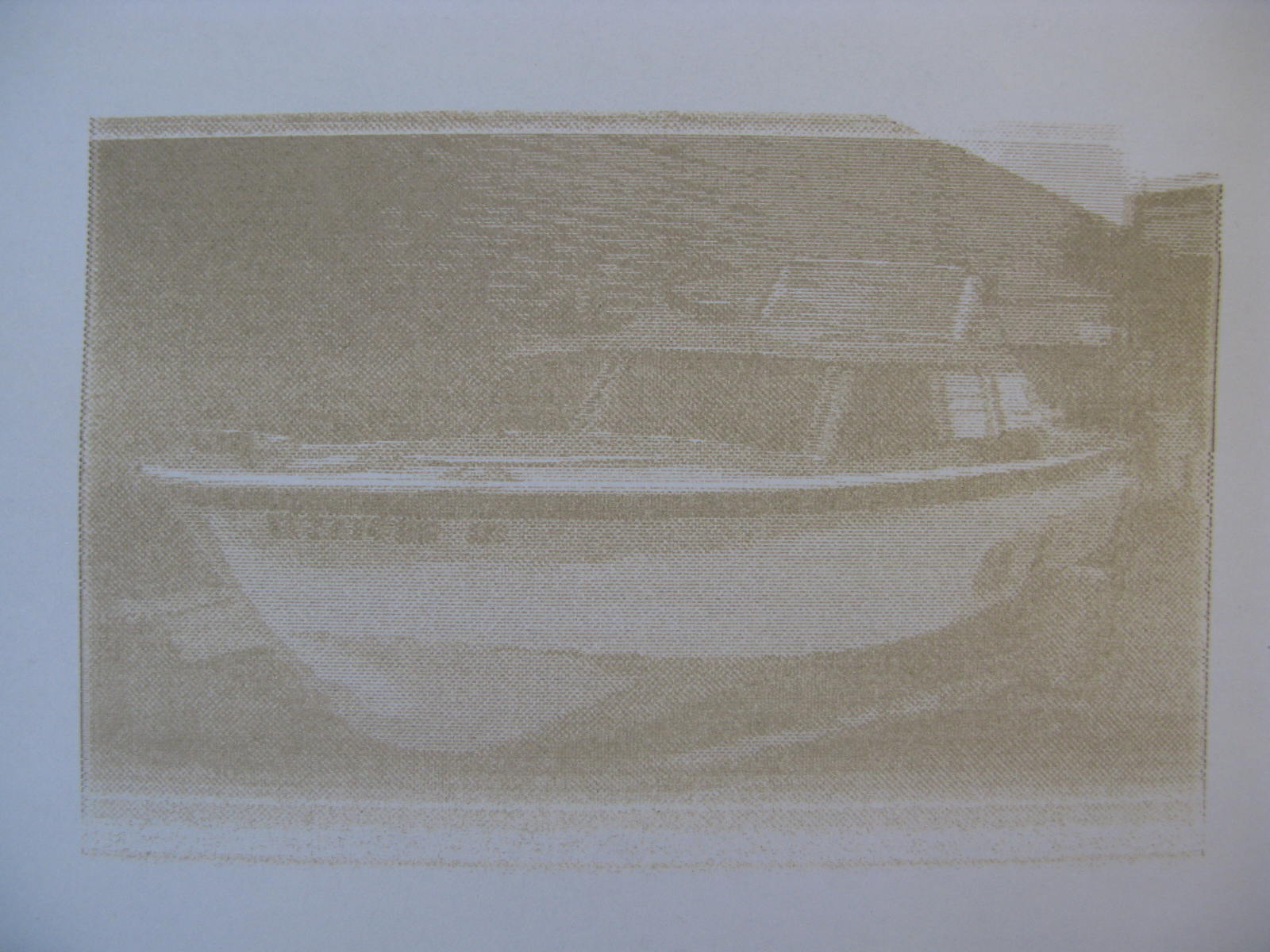

Try example this picture.. i don't get white stripe show to good and cap text too..
do i have to adjust picture levels lighter?

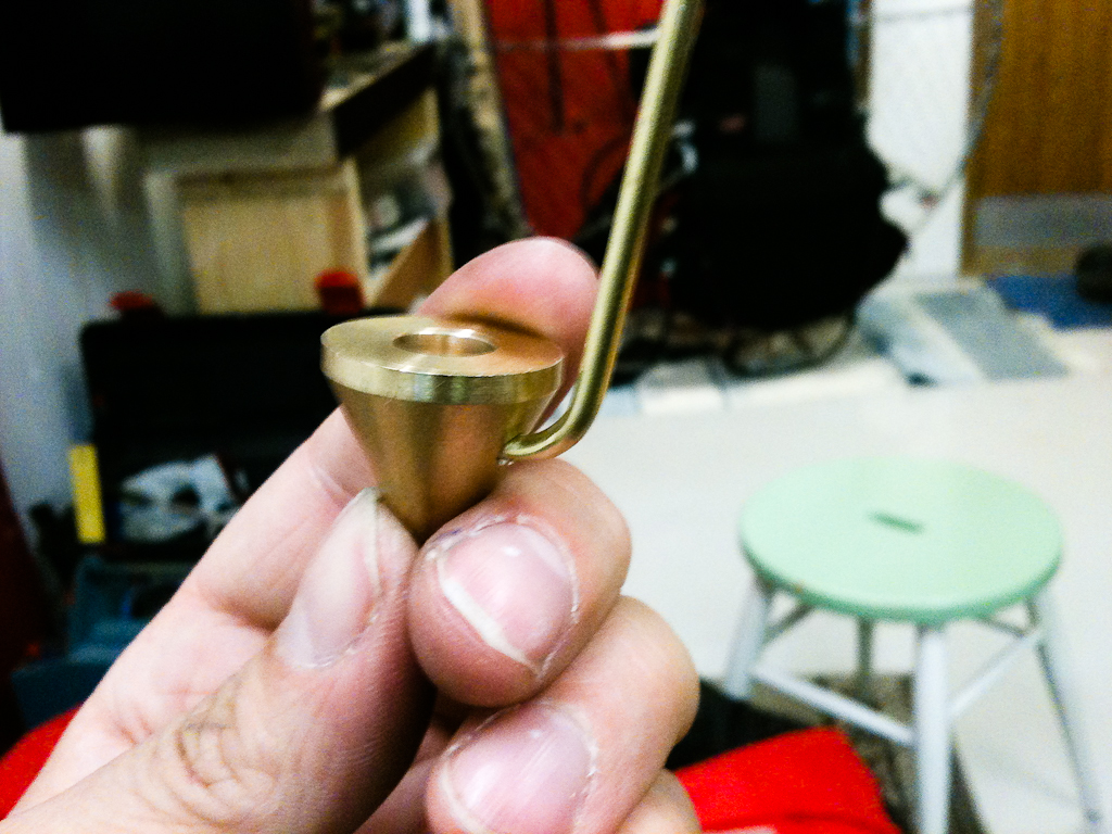

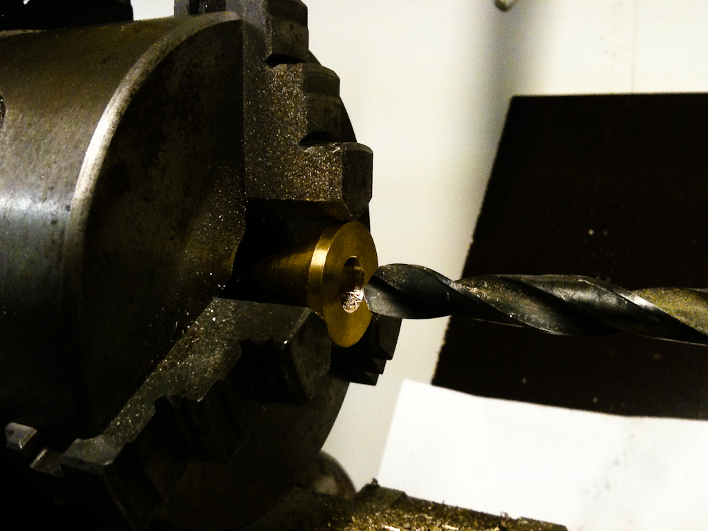

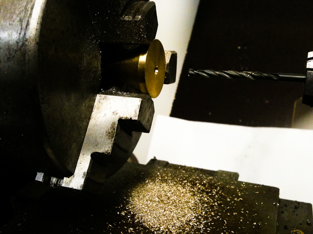

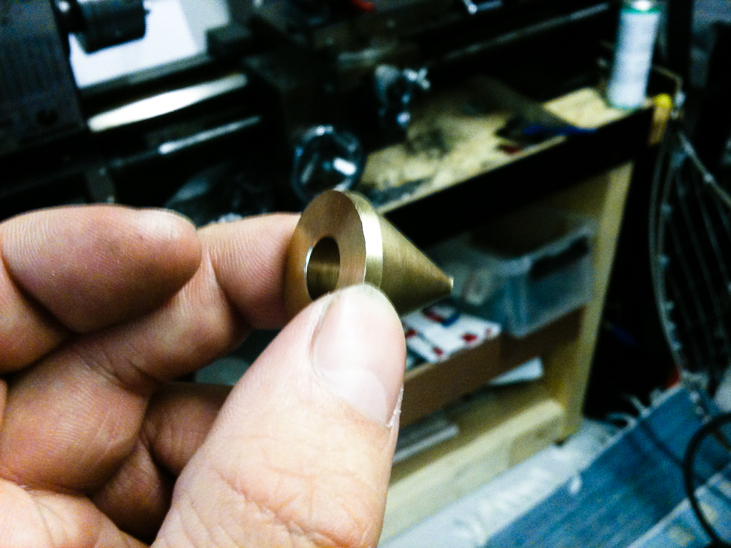

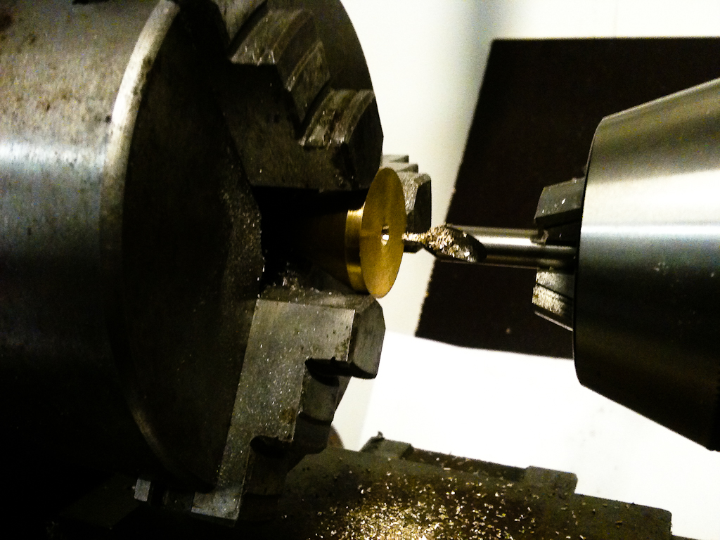

Little update my machine
First lathe cone and mark center point for drilling then drill center hole about 5-6mm drill bigger hole 10mm about middle of cone it should be like this next drill hole to side of the cone 3mm and bend pipe to it voila it's ready
