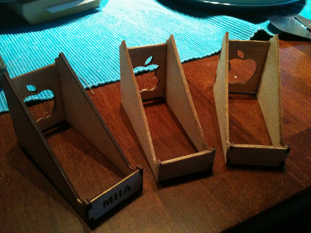

Today try how fast machine can go and accuracy and now i very impressive for this machine :)
Speed test Youtube
Accurancy test Youtube
Iphone stand
Iphone stand
