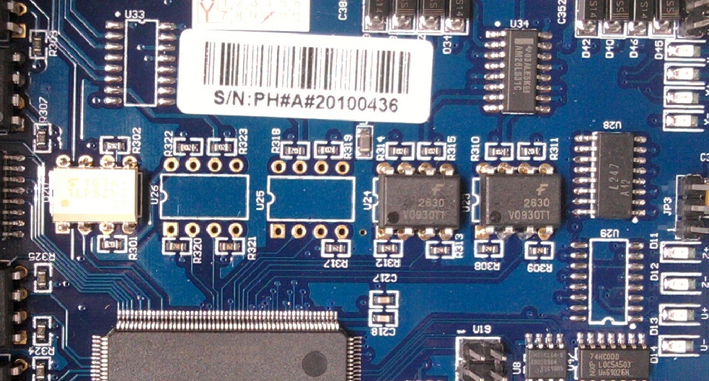

Hi, folks,
Many know that these boards were shipping with missing IC's, mine was too- here are the pictures - what I would want to
know is that if I add on teh IC's would the U and Z axis be enabled, I have already designed my machine to work with
these axis and was somehow not contemplating not having them on the control board, since I purchase stuff ans stack till
I have enough funds to proceed - I took the long time back bought controller board and wanted to get it on the machine
when I have noticed these issues, hope I can get em solved with the help from Tim or macro or anyone else.
I need help on the following
1. I see HCPL 2630 optoisolator, I am guessing that needs to be added to U26 and U25
2. I am guessing U33 is 26LS31 in SMD form as used for X and Y
3. U28 shows some absurd marking as L247 which is not an IC name - kindly confirm what U29 should be??? this is to enable
Z axis limits
4. I will not be adding U31, U32 or VR1 or VR2 as I am not using 2 laser tubes (is that what it would have been used for)
But for all this to be fullfilled I would want to know if the firmware on the V1.6 board would actually support it - its
a bit void to see that after acarrying out all the changes and still the board does not work.
Hope you folks can help!
Regards
Irfan

- Posts: 4654
Re: Adding IC's to the version 1.6 Laser controller board
Just added TLP281-4 to the empty slot of U29 will enable Z limit. Just confirmed with the tech
Now all the new cardas are built-in with the option after my complains. They assume not too many people use that option and trying to save cost.

- Posts: 21
- Joined: Tue Jun 15, 2010 1:33 am
Marco what about my first 2 questions - If my Z axis dont work with out U26 and U25 what is use of adding Z limit ic???
"1. I see HCPL 2630 optoisolator, I am guessing that needs to be added to U26 and U25
2. I am guessing U33 is 26LS31 in SMD form as used for X and Y"
- Posts: 21
Hi Marco - hope you have reached home safe -
kindly get answers for the above two points -
btw does the firmware of the Version 1.6 board support z and U axis?
