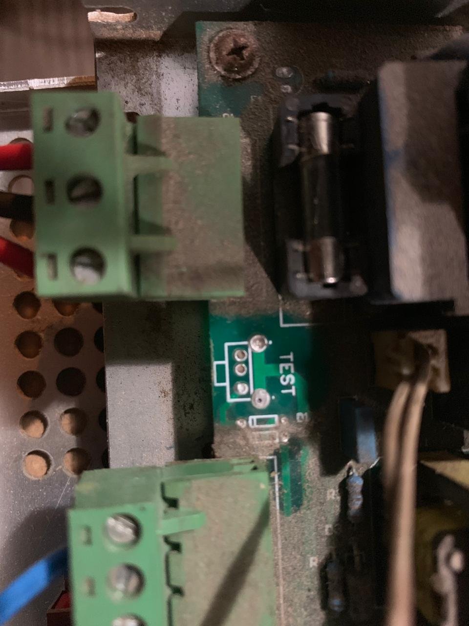

Hi i bought this power source hire a few years ago: 40W~60W PWM CO2 Laser Power Supply (AC 220V)
now i am having a problem, my laser is not firing, and when i chech the power source it doesnt have test button so i can not determinate if the problem is the power source or the laser tube. thanks
Laser wont fire no test button on power source

It is possible the water protection switch is bad. if that switch is bad then the laser power supply(LSPU) will not activate.
if you have a digital multi meter (DMM) check for continuity by putting a prob on each side then turn on the water chiller. if it beeps then the switch is good. or it can be a bad switch on your cover that can prevent the machine to work.
