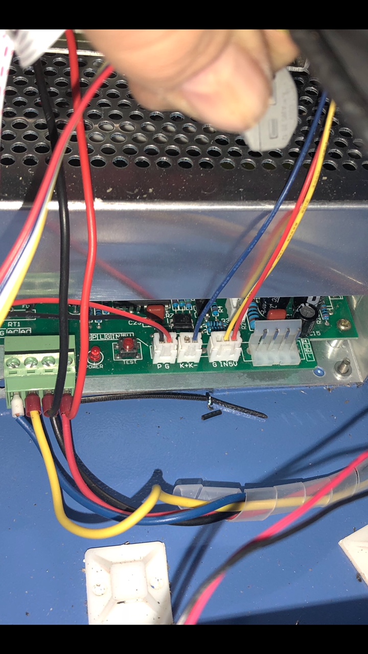

I appreciate your time! I am leaving today for a trip, but I will try your suggestion when I return next week. As I originally said, I really want to be proven wrong about this,lol! Another thought that crossed my mind is that I may need to check my wiring to make sure I have the pwm function properly configured. I have one of the laser psu that is almost impossible to find a clear diagram for the retrofit. At the moment I have P and G connected going to gnd on the 708c, -K not connected, +K going to TTL, IN going to PWM, 5v to water protect, and not using the rest (see attach). However, there are misprints on the circuit board, so Im always questioning my setup. I can cut, engrave, and test fire with no issues though.

As the L in TTL stands for LOW-level, i immediately thought it should be connected to the -(minus)KJohnpettybone wrote:….. -K not connected, +K going to TTL......
Looking at the photo, i see a wire coming from -K and nothing from +K..
So only mistaken in tekst, not practise
WHY do you connect the 5V to the Waterprotect????? The flowswitch is a low-levelswitch which connects to GND when activated..
The +5V is only used when you use a potentiometer for powersetting (or... like i do...Supply a digital current-meter for the readout of the lasercurrent)
I think the rest is OK (I guess P stands for Protect, G for Ground

I was following a schematic I found online when I connected the 5v to WP. I assumed it was needed for an interlock, but I have since found the water protect terminal is for the fancy chillers. I made my chiller out of a mini fridge, some copper tube, and a marine bilge pump,lol! Hence, I have nothing running to WP at the moment. The 5v is just capped.
