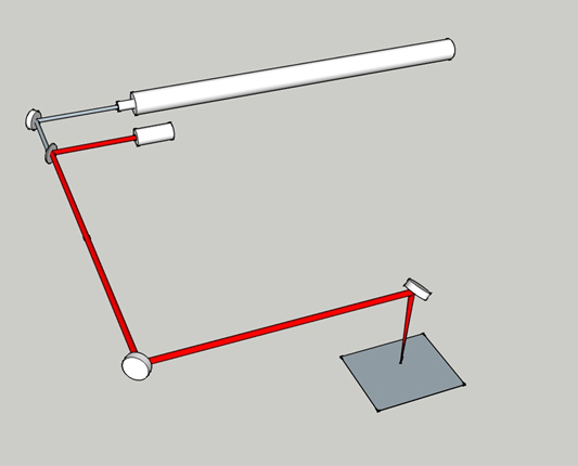

I'm thinking to customize a laser pointing module without using using a combined lens/mirror. Instead, it could be mounted right next to the laser tube output and beam shoot out in parellel with the CO2 laser. I need to do some testing with a 5mW red dot laser module.

Don't think that will work. The two beams have to be coaxial, which is the purpose of the combiner lens. If you are parallel, it will not strike the first mirror at the same point. If you aim it at the correct spot, it will be at a different angle.Tech_Marco wrote:I'm thinking to customize a laser pointing module without using using a combined lens/mirror. Instead, it could be mounted right next to the laser tube output and beam shoot out in parellel with the CO2 laser. I need to do some testing with a 5mW red dot laser module.

Well, the reflection mirror of a laser machine is at least 20mm in diameter. What I'll do is to have a tiny reflector mirror mount on the tube side and angle to the Red laser beam. The beam should strike straight right on the 1st mirror. As long as the light beam within 20mm limit , it should be able to reach the focuse lens and haing the red dot target to the exact point of the CO2 beam.

no, the beams must be colinear. You cannot run a parallel beam and expect it to hit the same spot because of the lens focus. It will be offset by the distance it is hitting to the side of the lens.

There is a manufacturer out there that is putting a red diode on the laser lens assembly at about 30 degrees and pointing the spot at the place where the laser is focused. It would work OK but it just adds weight to the head reducing the speed you can engrave at.
