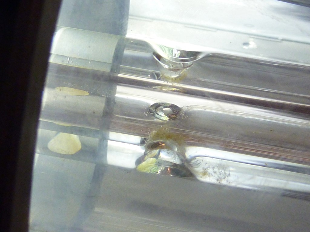

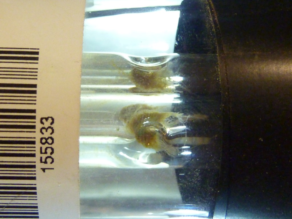

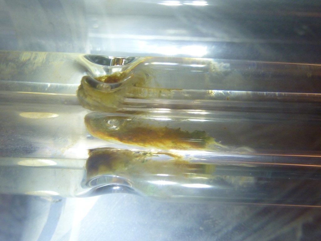

I'm looking for ideas on cleaning out gunk that is collecting at the two pinch points in our 45W LO tube. I think the gunk originates from water tub algae that gets pumped thru the tube and then collects at the two narrow points in the glass tube. Water flow seems OK right now, but I am concerned that further buildup will put tube cooling at risk.
I'm considering trying to reverse flush the tube with water and some cleaning additive. Vinegar seems like a viable additive that should not degrade the pump or silicone tubing.

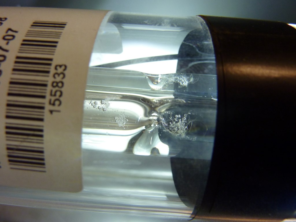

We discovered a good way to clean out our tube using Oxiclean powder. Here is the procedure:
This procedure was very effective for us as shown in the before/after photos.
- Reverse water pump connections so the water will flow from the laser emitting end to the high voltage end (we're "backflushing" the tube)
- 3/4 fill a gallon bucket with warm water
- add 4 scoops of Oxiclean. The scoop was provided with the product. Mix to dissolve.
- add pump to bucket. Return tubing goes into bucket
- start pump
- run pump for about 1/2 hr
- flush out tube with clean water to remove any Oxiclean
- re-connect water pump so water flows from HV end to emitting end
