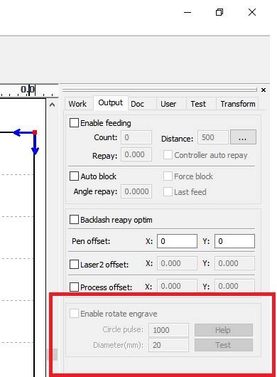

I have mechanical and firmware settings figured out and set. I can jog the U axis on the machine just fine. No matter what setting I choose or change I cannot get the U axis to move during a job. The attachment is what LOworks only shows. LOworks version 8.01.24
Edit: Further research has shown that a lot of people just unhook the respective axis to wire up the rotary in it's place which is not a legitimate answer for me considering I bought the controller knowing its a 4 axis controller. Any 3 axis controller could use this "workaround" to be ran this way and that's the reason I went with the R5. Is there a way to make this work?
