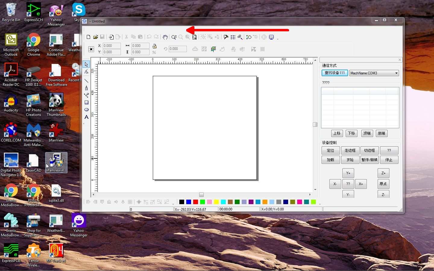

OK , I found a screen shot of the LaserCad V7.79.2 and it was in english, so I uninstalled the lastest version, back to square one. The IN downloaded the V7.79.2 version of LaserCad. Extracted the files using Z-zip program. Then after the files were extracted, I clicked on the setup button. A small screen poped up for the install and it was in chineese . I clicked on the Lasercad and then the button to change it to english and then hit the install button. The Install looked liked it worked, then I installed the USB drivers and after a couple of minutes it said OK. So I went to my programs list and clicked on Lasercad and started it up. When the screen came up, Again it was all in chineese See the photo below. Not only is it in chineese, but the whole top row of buttons for File, edit, draw, tool and such are missing See the red arrow. Can someone plese tell me what I am doing wrong. This is the 4th time I have tried to install an english version and all I get is chineese. Thanks Dan Stuettgen

By default, it is in English. I guess you didn't turned off your antivirus program, did you?
Select English before click install
Uninstall the LaserCad, then delete the folder and run the installation again. Turn off the antivirus program just for a moment when doing installation

Marco: thanks I will do that when I get home, but I suspect that I might have an issue with my computer as I noticed that on a couple other program that I use, some of features stopped working. This all seemed to happen after I tried installing the smoothie Board software before I purchased the E5 DSP controller. I tried loading the DSP software on my laptop last night and it worked perfectly and even let me Import a DXF file that I had created in DeltaCad, a real cheap $15.00 cad program that Walmart sold many years ago. So I am good to go, just waiting on my 24V 5amp power supply to arrive so I can start putting it all together. I have a 24V 3a supply, but your wiring drawing showed a 5amp one, so I ordered one. Thanks for your help. Dan Stuettgen
