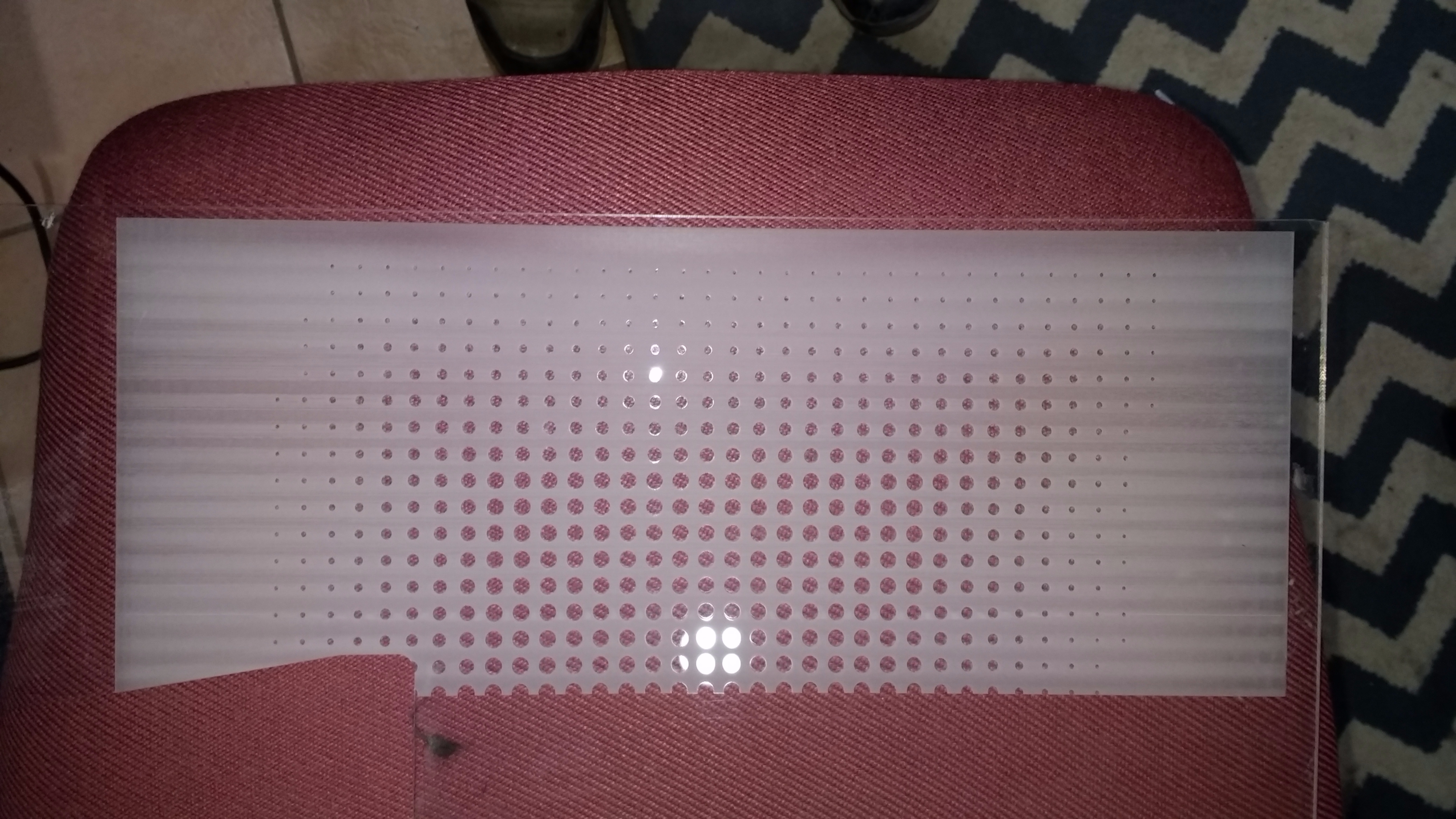

Jumping in here to see if you have any info on my problem which I am thinking may have to do with the pwm frequency setting.
Like yours, mine defaults at 20K. In the manual it says the range is between 20K and 80K (LO-X7 manual page 21). It also says that if the setting is too low it will lead to unbalanced power with "Heavy Point" appearing during processing.
I am trying to engrave a large piece of acrylic which is mostly solid fill with dots here and there. The power level is the same for the whole piece.
I am getting "stripes" so to speak
running left to right (X direction) that are maybe around 5-8mm wide in the Y direction. Every once in a while it will engrave a much deeper line for one and up to a few passes then settle down again (can't see in in this photo), but it still gives me the "change in power level" every few mm. Obviously it doesn't have to do with the closeness of the laser to the lens otherwise it would be changing in the other direction.
I'm thinking that my pwm frequency setting is too low. The question is; "what is the correct setting?" Does the power supply care or is there an optimum setting for each particular brand of power supply and if so where do you find the information?
Has anyone had this problem or know the answer?

It's better to start your own topic as this problem is somewhat different from soenlin's.
but for this time:
I see some banding too (vertical stripes)..
The horizontal striping can be a instable tube.. I had that with an old dieing tube.. After i placed a new tube this problem was gone.
It can also be some interpolation effect when your scanlines are close to the step-resolution of your Y-stepper..
You might use the next trick to get a more equal surface:
Open your picture (with the dots) in Photoshop or a similar program. If you use a scangap of 0.08 (~316dpi) set the picture size to the right dimensions with a resolution of this 316 dpi. Adjust de levels from 0-255 to 64-255. convert to Black/white (1 bit) with a dithering you like (Floyd-steinberg for instance). Instead of an equal picture you will get a lot of dots.. The result, when lasered, will be a much more even surface.. Maybe even your horizontal stripes will be gone??
I tested about all PWM frequency's but i didn't experienced any difference at all.. All engraved parts where exactly the same crips and equal..

It is possible it is a tube on the way out. This one came as a spare when I bought the machine. It is a good quality tube but I don't know how old it is. I just changed it out a month or so ago when my first tube fried due to cooling failure so it doesn't have much time on it but the age may be the problem. Any insight on that is really appreciated.
I did as you suggested and it makes a big difference but still not perfect. I just am not sure what the de levels are you referred to. Where do I find those settings?
This came to me as a .ai file and I use Corel x7. I converted it to a bitmap then to black and white inside Photo-Paint at the resolution you suggested.
I am still playing with settings as it is a little too dense for the client's requirements.
I am assuming that if I change the dpi of the image, i have to change the scan gap to match as well as the dpi setting in Raycam?
I will remember to start a new topic next time.
-SF
