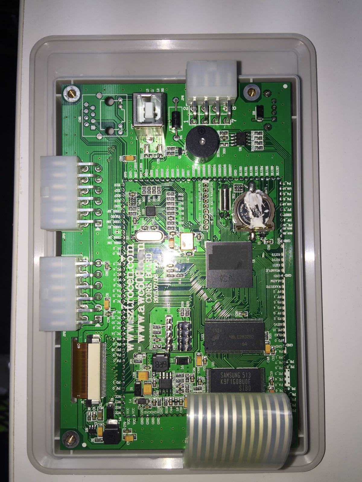

I already thought something like that, but where can i find this battery (in which unit?).. Is it a battery (something like CR2025) of something like a big Capacitor.. Is it placed in a holder or do i need to solder it out..
Just a few questions before i dismantle the machine..
PS.. just found it.. it is in the display unit. You have to take out the PCB as the CR1220 cell is on the back..
Not a type of battery that i have spare in the house..
Re: LO-X7 with Altzheimer?
CR1220 3v battery

I know its an old thread but, Thanks for this info!
It was driving me nuts that neither of my LO-X7's would keep time/date. Well after a short trip to the local drug store and $10 later, one of my LO-X7's now keep time correctly)....I have the program to update the one to the system time, the one that's correct now is still on laserCad..I changed the battery in the one running RAYCAM but the time setting software doesn't talk to that DSP....Anyone have the software for that? or know another way.
