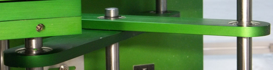

I'm finally getting back to my 900x600 laser project.
My Green Z-Table barley lifts my vacuum bed of 15 lbs.
The table has a maximum lift of 50 lbs.
Vacuum bed = 14.5 lbs
Honeycomb bed = 16.5 lbs
Cutting material = 19 lbs
The scenario;
Starting at full lift, the table will bottom out without issues.
When trying to come back up, I get a slow grind/whine from
the stepper and it wont lift. I can get it to lift with some help
from me.
I can go up and down fine as long as I don't drop too far down,
lets say 40%, If I drop more than 50%, I get stalling when trying
to lift back up.
My set up;
LO X7 DSP, 36vdc 10amp supply,
3MD560 driver set to;
Current 5.2a, standstill current 50%, 4000 step/rev
Software set to;
14.0 UM, Z home/work speed 200, start speed 15.0, max
accell 200, max speed 300.
Is my issue mechanical, software settings or driver issue ??
Green Z-Table doesnt lift much weight.
