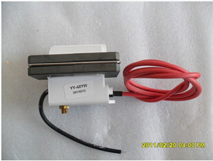

Thanks for the suggestion. I got a spare tube so I started installing it yesterday evening. Didn't manage to finish it so going to finish it today and hopefully that will solve the problem. I'll let you know.
I attached a picture of the component I replaced. Since it is completely sealed I can't look inside. I was wondering what is the purpose of the metal u-shaped thing on the black part of the flyback

You should not connect the returnwire (kathode) to the case of the supply. Normaly there is a relative thin wire going in the supply. |It can be that, in there, the signal is used for currentsensing. When you connect the tubes Cathode to the case you will bypass this circuit (if it exists..)
The metal U-shape is to keep the two feroxcube parts together tight. It looks one piece but it will most probably be two u-shapes pressed in the highvoltage-transformer.
