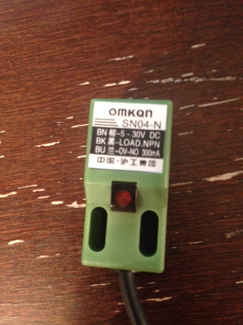

I have recently upgraded to the X7 from a Leetro 6525 and am having a rough time figuring out the limit sensors. I have been looking through other posts regarding it but cant quite figure it out.
I have swapped wires around but nothing seems to work. I did find that I needed to connect 24v power from the PSU and that at least turned the limit light on when it gets to the end but it doesn't stop. The wierd problem I noticed is that when I was messing with the X axis it at one point made the Y axis limit work. I am at a loss at this point and would appreciate any help I can get.
Here is the sensor I have
Limit sensor an04-n.JPG (122.75 KiB) Viewed 2522 times

I guess that this limitswitch (proximitysensor) has three wires, and probably brown, blue and black, right?
Blue is your GND-wire, Brown must be connected to the +24V and Black is the output, which should be connected to the limitswitch input of the controller.
Think of a corner where you want your homepoint to be. for instance right-top.
Place the head somewhere in the middle and see it it moves to the right corner when you turn on the machine. If not, you have to change settings..
You only need two sensors normaly, both in the corner wher your homepoint is. And maybe another for auto-focus..

You knew the one! That's exactly what I was missing, thought I tried all the configs with the wires but I guess not. My ignorance was killing me lol. Works like it should now thank you very much Kees.
