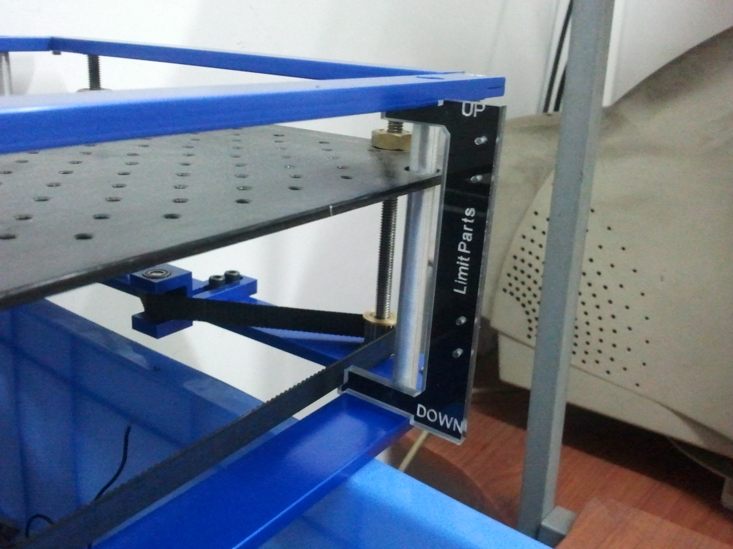

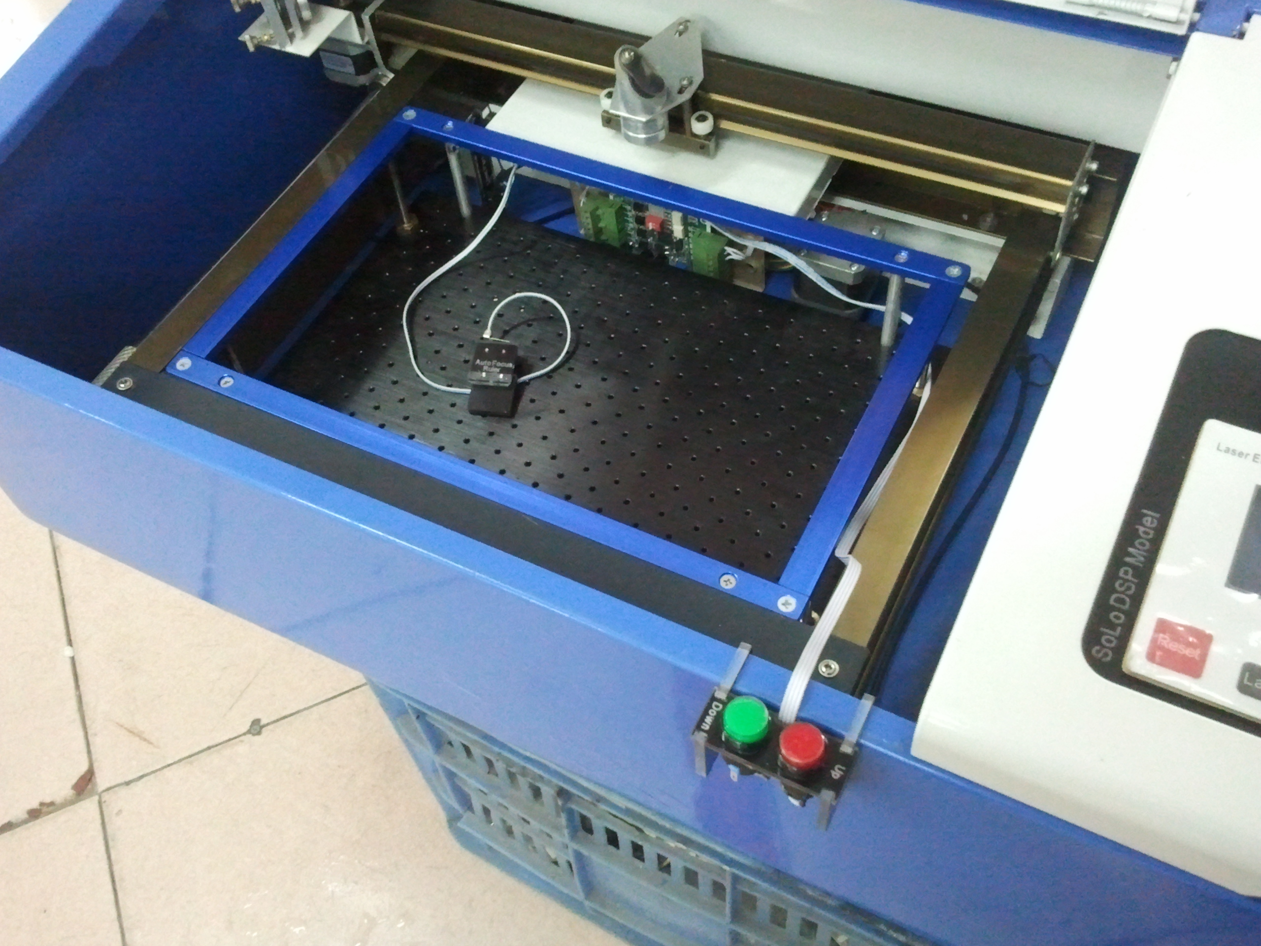

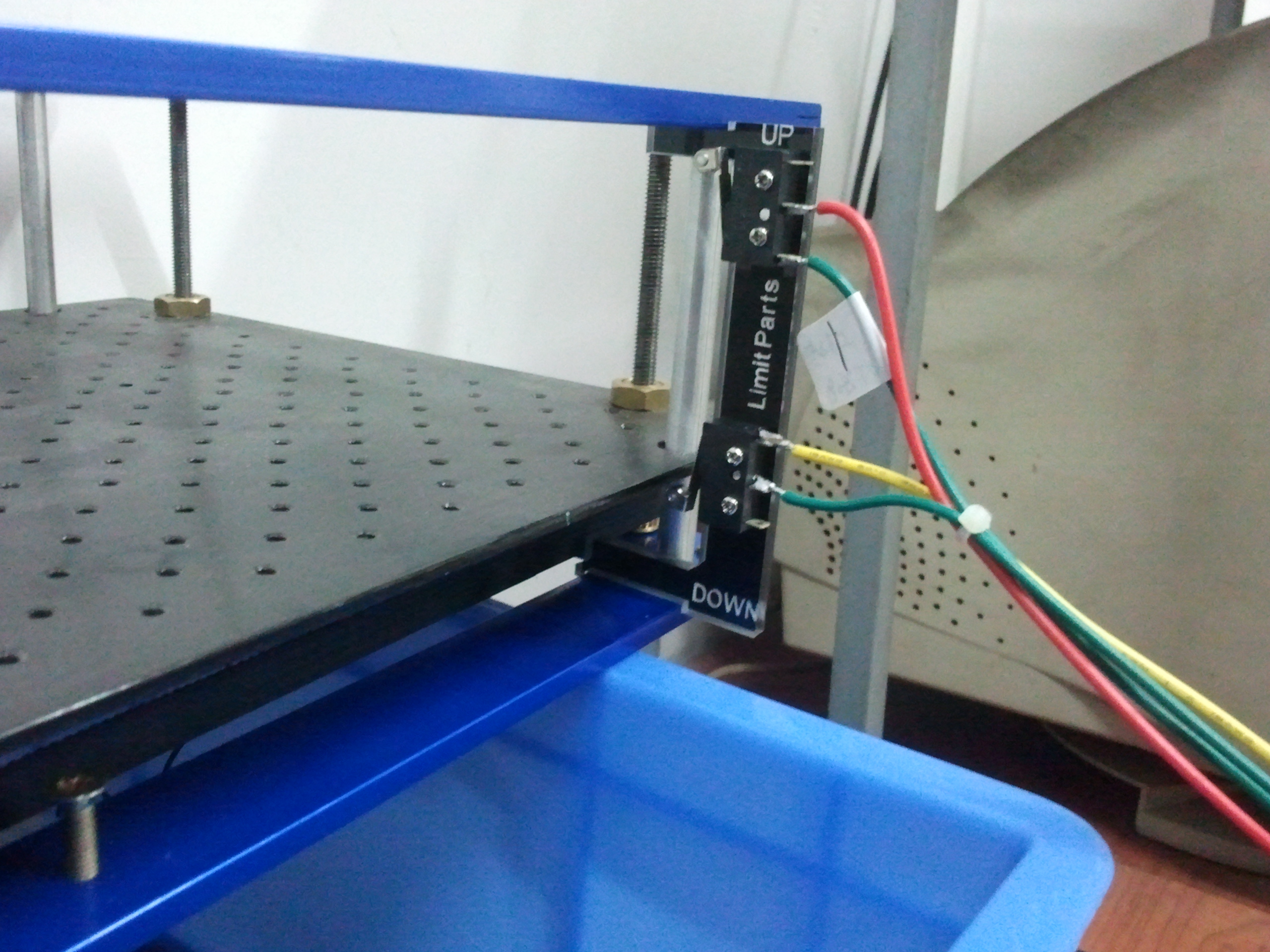

The file contains parts list and layout for doing DIY limit switches for the K40 mini Z table
You may use DSP or the EC04 controller board to control the bed up and down

Update: Uploaded the step by step built photos. Do not tight up the four lead screws because doing so, the Z table may got locked up and not moving.
Click to download: www.lightobject.info/download/Manual/Po ... -Steps.rar
