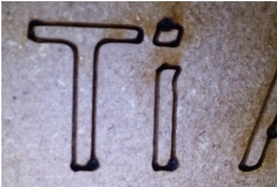

I have finished the build on my 48" x 24" 40w co2 laser. I am pleased with the motion control but not yet satisfied with how the laser fires.
Attached is a pic from a test lasing.
Initially, I was using pin 17 from the parallel port to turn on or turn off a relay. When the relay closes,"Gnd" and "L" on PSU are connected and the laser fires. When the relay opens, "L" and "Gnd" are no longer connected and laser stops firing. It "works" but there is a slight delay in the closing of the relay, so I am trying to figure out how to connect from my break out board to the Laser PSU without a relay
I tried connecting pin 17 directly to "L" . The laser would fire, but I could not make it stop firing.
Using a voltmeter from pin 17 to gnd I could get 3.34 volts or .14 volts depending on whether pin was active or not
I have tried several different alternatives. I enabled the Z axis using pins 6(step) and 7(dir). Using voltmeter I measured 3.34 volts or .14 volts from pin 7 to gnd.
I enabled the A axis using pins 8(step) and 9(dir) and measured 3.34 volts and .14 volts from pin 9 to gnd.
I can get the laser to fire with any of these, but not go off. Is it because my voltage is not 5v?
