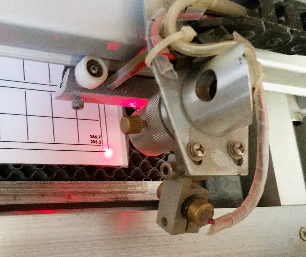

I printed a page limit grid with black dots on the 4 corners of my work area and one in the center.
For my system the x axis is left/right and y is front/back with the origin in the upper left.
I assumed I had a stepper motor setting that was off. The two settings were within 1% but not the same number.
After checking the x axis I came up with a better number, and the y axis seemed to work with it just fine.
The problem is the spotting light is on target for 0,0 and the back right dot but front right dot is missed. The spotting light is 2mm outside my working area.
The 'box' is not square with the angle at 0,0 being over 90 degrees and the back right under 90 degrees.
The spotting light is about 1mm right of the center dot (this is with the origin and back right dots in alignment)
Do I need to adjust my mirrors or could the motorized frame be out of square slightly? Which is more likely?
I adjusted the mirrors before, the light doesn't hit in the center of them and is closer to the edge than the center for all but the first one. It still works though.
Any suggestions?

Turns out the frame is square but the arm is off about 1.5mm, making it lower on the right side. Perhaps I'm calibrating from the wrong side - I should align the calibration sheet on the left instead of the top. I'll try that next time I work on it. Maybe if I align the beam again... but the spotting light is the problem, and the beam is right on the light!

I aligned the grid this time using the dots on the left instead of along the top. The spotting light is then 2mm below the lower right mark. This would be consistent with the cutting I've seen with it. Next I adjusted the stepper motor for the y axis (I think they are switched) so that the dot aligned exactly on the right two dots and discovered that the lower left dot was 2mm short of the mark. So I recorded that number and adjusted the stepping motor to the left dots and got a lower number. By averaging the two numbers for the setting I get a better cut - 1mm short on the left and 1mm over on the right. The arm is clearly crooked, I've measured it with a square. The frame is OK though. Next step will be to adjust the tension on the belt to see if that will fix the problem, the adjustment screws are under the glass tube and will require disconnecting it. That will be a March project.

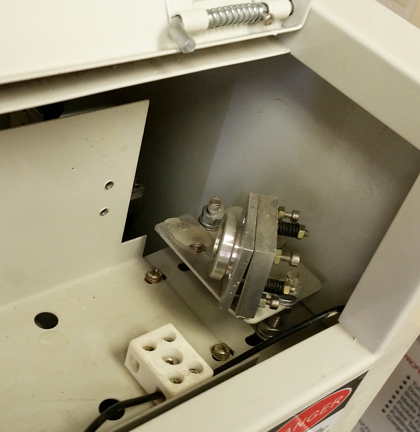

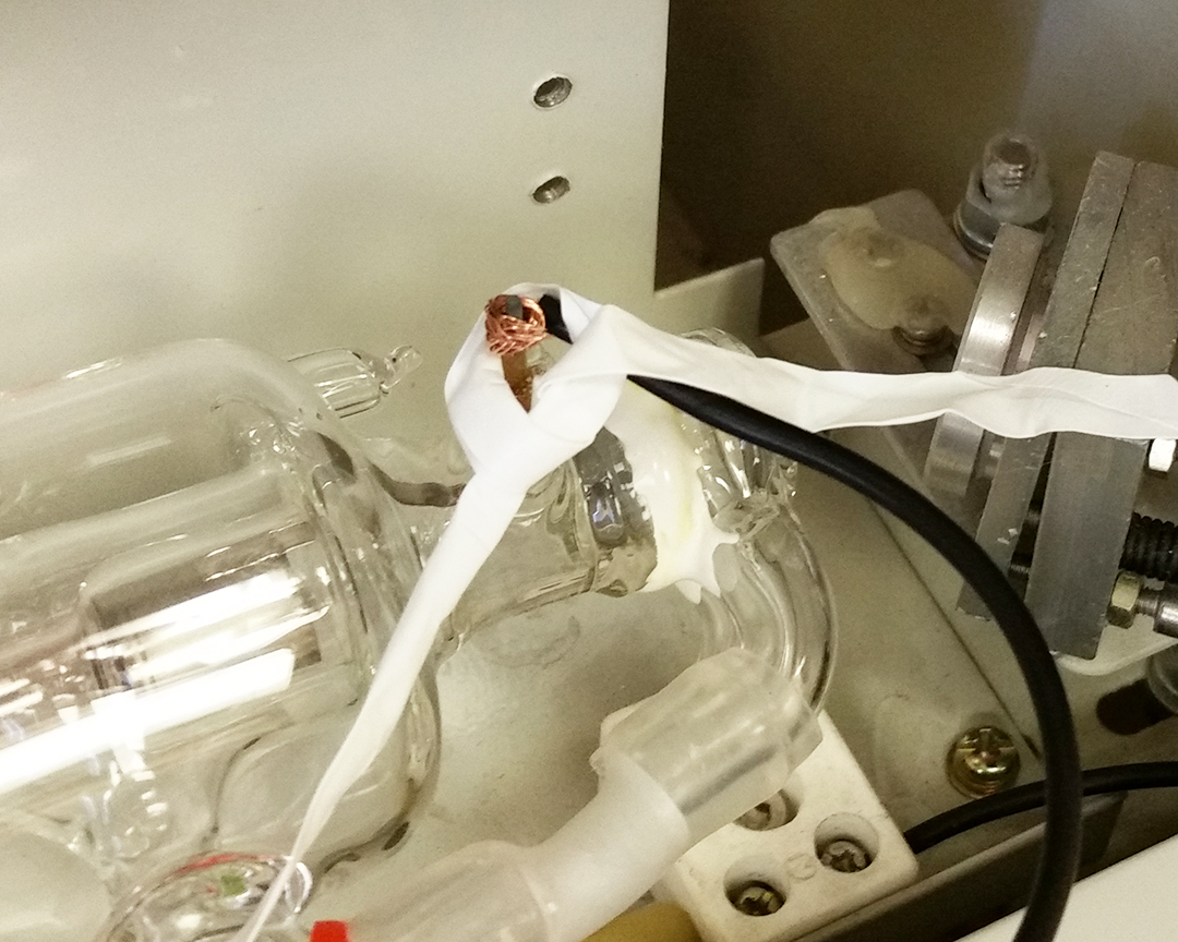

The tube died and I took the time to replace it today. After removing the tube I see this:
There are 4 screws holding the plate in place, the plate must come out. Fortunately they have nuts with washers and locking washers on the back. Sure glad they didn't drill and tap the hole for easy access, I planed on killing the whole afternoon on this project, and shortcuts just won't work. After I get the plate out I see the belt adjustment for left and right:

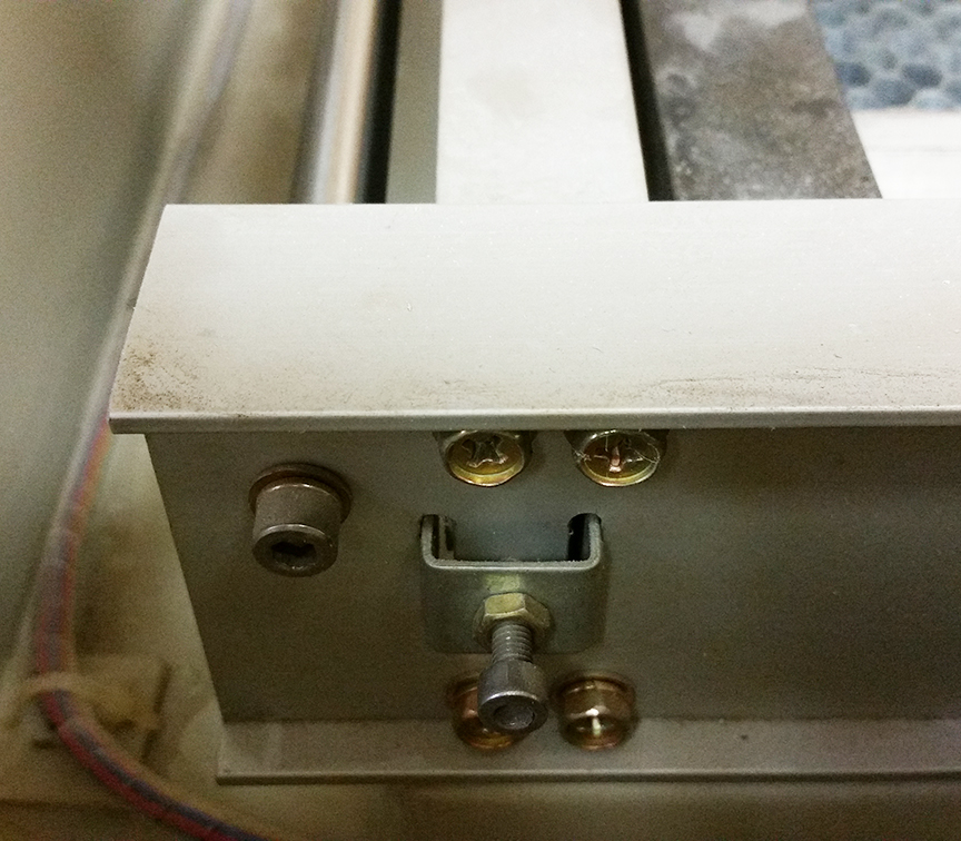

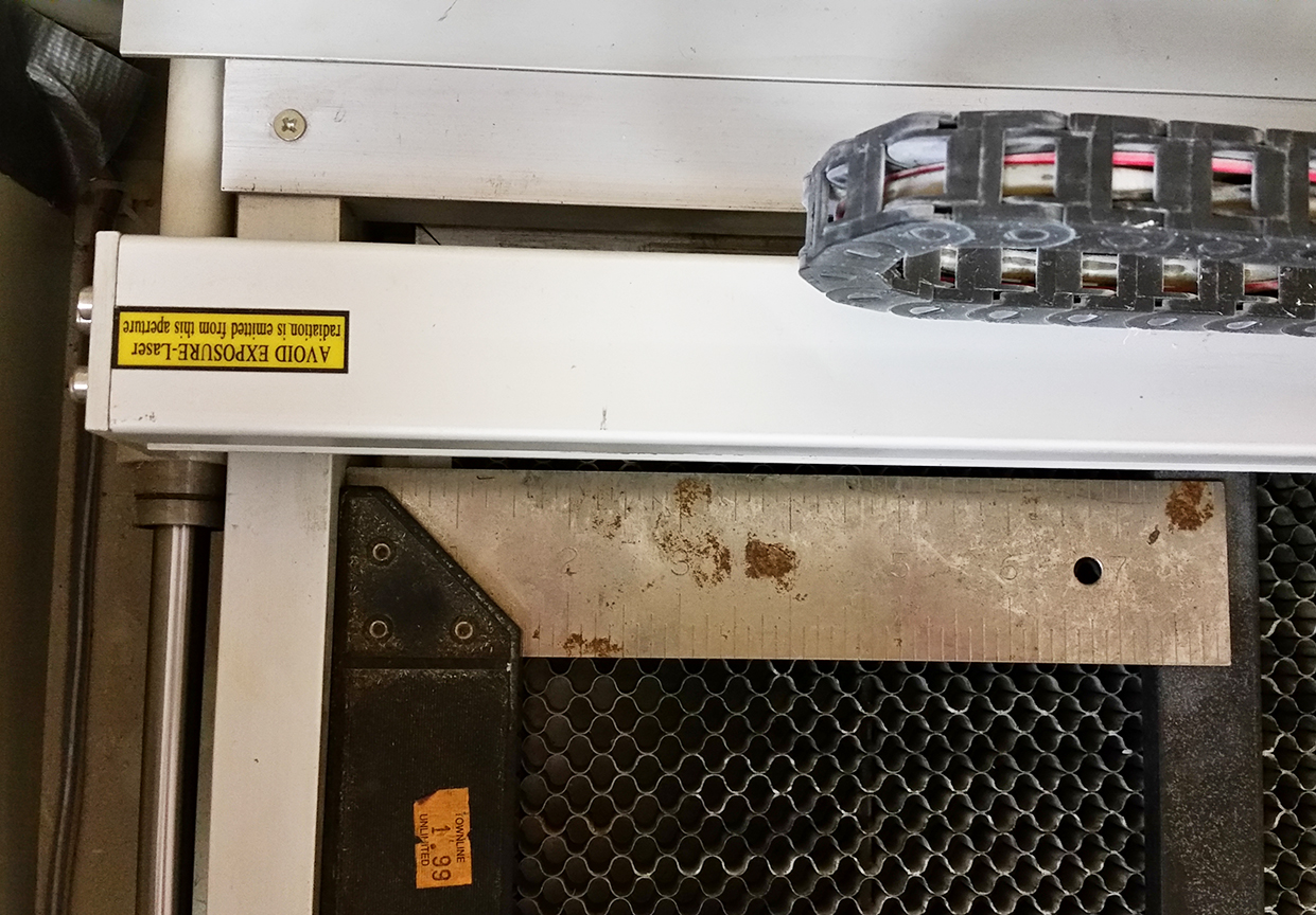

Seems the only thing I can do is adjust the belts, so I loosen them both up all the way. There is about 5mm wiggle in the arm at this point. If I tighten the left side up and not the right its still off by 1mm (better than the 2mm its been off).
I put tension back on both belts. Can't hardly move it, so I loosen it up. Alignment still off. I grab each end of the arm with my hands and try to bend it into the right place. Then I hear a pop, or more like a thunk. I check the square against the arm:
It looks perfect. I tighten the belts to a little more that it was, but light enough that it still moves easily. Then I put it back together, and oil the rails. When I add the new tube, I try the Teflon knot suggestion I found in the owner's manual (FSL build):

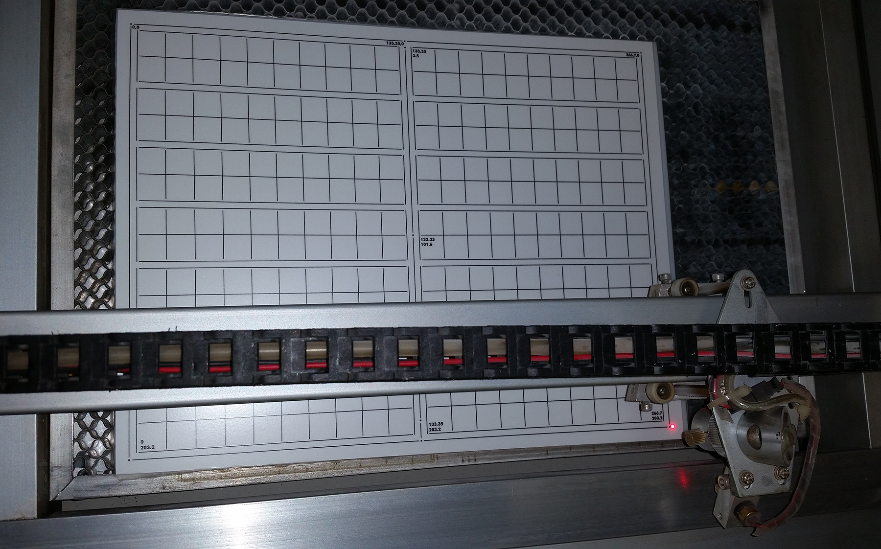

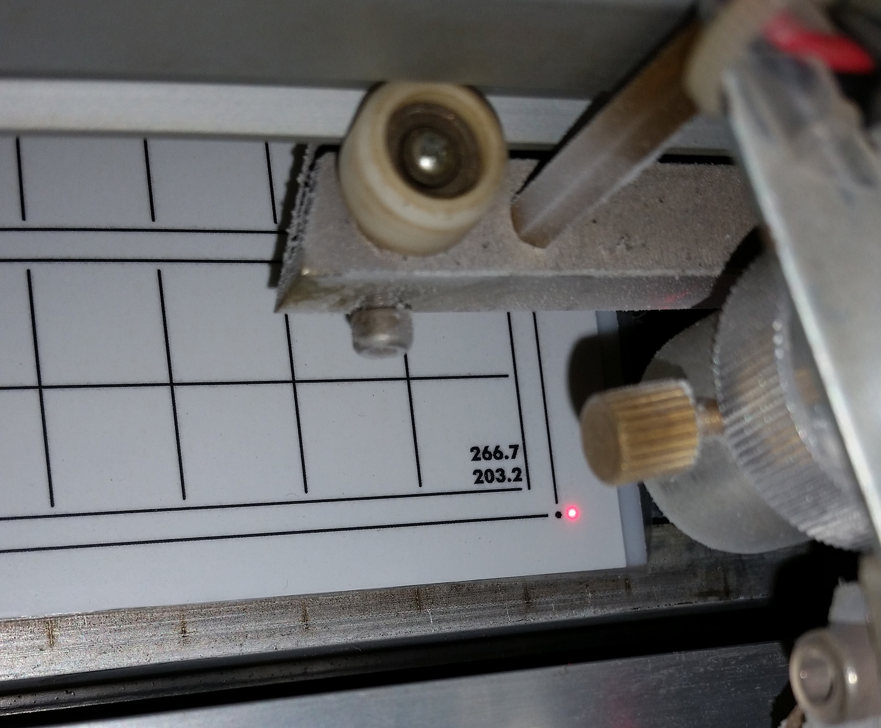

Finally I do a calibration test:
Everything seems to be right on now. Maybe need to make some minor adjustments to the stepper settings, but its very close.
I suspect that the right side was off by 1 notch in the belt. This may have been due to the previous owner. He would send it out of range and you would hear this horrible sound of the notched belt slipping. Something I avoid.
