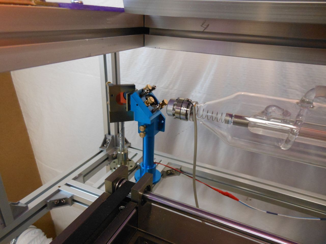

Can you describe how the "standard" combiner mount is supposed to be used? Which side does the CO2 beam enter? I'm guessing the side with the "small" opening, which is presumably also where the combiner mounts? Meaning the reflecting surface is facing the adjusting knobs?
I'm trying to envision how I'd mount this thing in a K40 on the back wall of the cutting chamber. I'm thinking a simply "L" platform connected to the back wall below the beam path would do the trick.

Re: how indeed does a beam combiner help?
The side with screws are facing the laser tube. The hole with threaded is the output and facing to the first mirror or second mirror if there is no room to place the mount in between the tube and the 1st mirror
Like this. Tube is to the right of the blue beam combiner.
