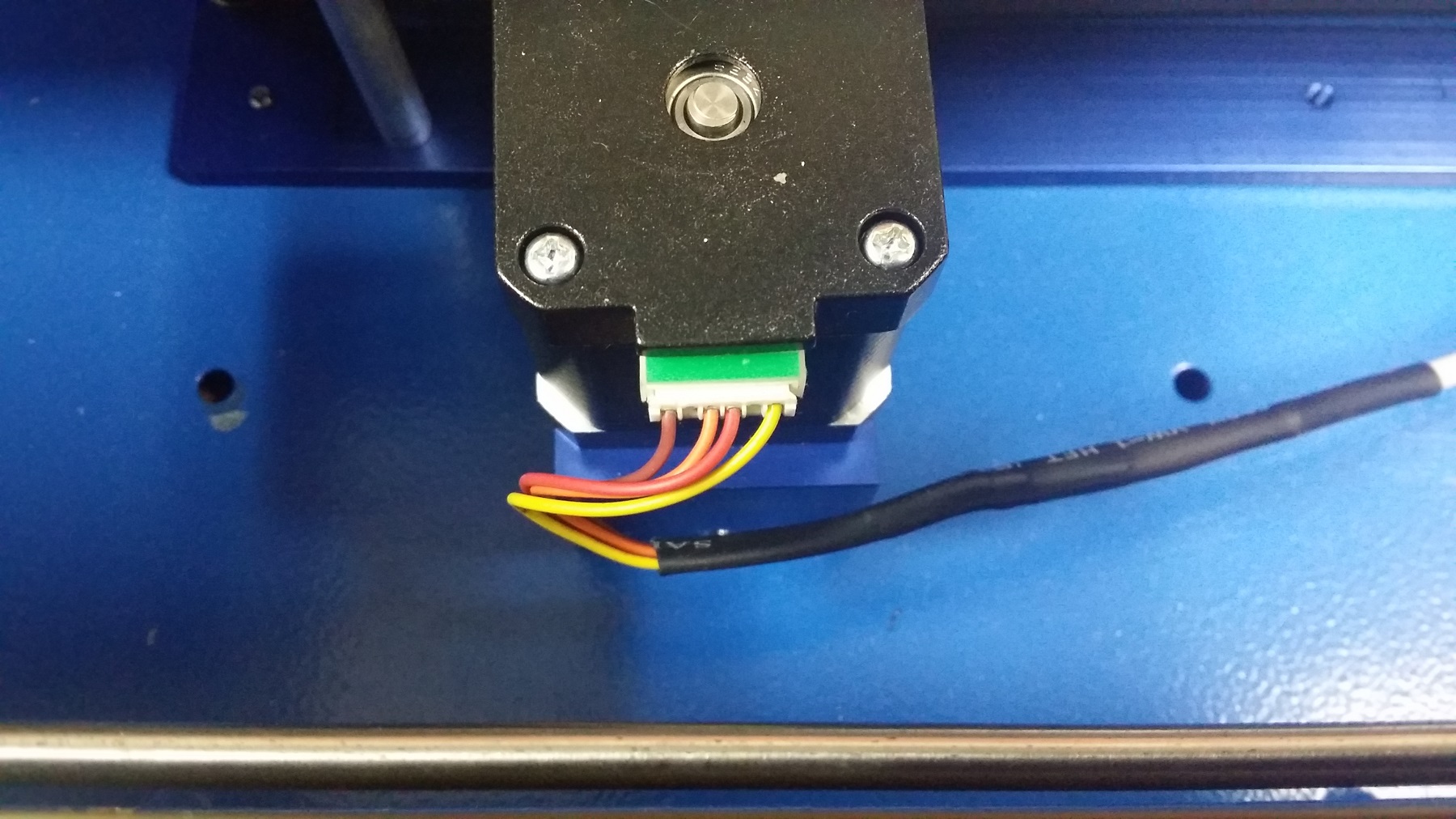

For some reason i cant get the Z table to work on my machine.....Anybody have a decent diagram on hooking it up to the X7 DSP?

Still cant figure it out....Anybody have one working that can tell me which pin goes where?

Does it matter which one of the pairs are + and -?
I have it as follows
Pin1- Brown to A-
Pin3- Orange to B-
Pin4- Red to A+
Pin6- Yellow to B+
I know it has to be something silly right in front of my face but i cant see it.......
Also the controller at the moment is set at
1.5 amps
8 steps
But i have tried multiple configurations.....
Mike

Can you check the motor to sort out the pair: A+ A- and B+ B-
The cable could be wrong as we have a batch that came with different configuration
Use a Ohm meter to check the resistance. If you can see some resistance (not open circuit), then it is a pair of either A or B
The pair could be 1&4, 3&6 or 1&3, 2$4

Got it to work Finally......The pairs are 2/4 and 3/5 So had to change the pin out to terminals 2/3/4/5
