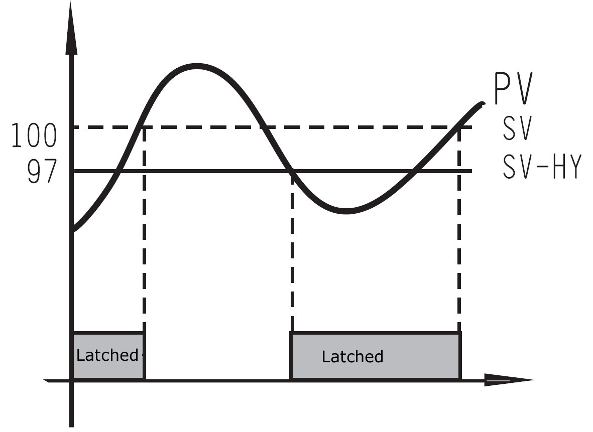

How about a differential temperature control?
Say you want 145'F and fire it up when it drop to 140'F?
If that is OK, use Outy= 4. Note SSR will be disable but Relay 2 will be used to serve the controlling while the Relay 1 acts as alarm.
Above is wrong! Actually there is two Differential output Outy=3 and Outy=4
During Outy=3, J1,J2 serves as alarm and SSR differential control
While Outy=4, J1 serves as alarm, J2 serves as differntial control and SSR diabled
This is the latest features. Let me post the curve for you to view it. Just a minute...
PV = current temperature,
SV = target temperature,
HY = differential temp.
During RD= 0 (heating),
PV <= (SV-HY), Relay or SSR latched
PV => SV, Relay or SSR unlatched

Re: JLD612 tuning help
OK, this is very cool! I look forward to seeing your new manual, Marco! Great features for many of the problems that have been posted here recently. Hope everyone sees this post.
