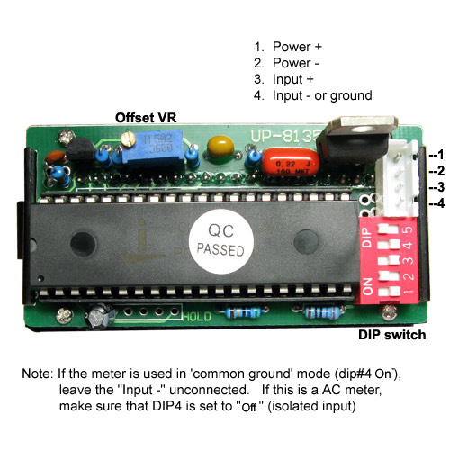

Could someone please post the jumper settings to help me narrow down decimal position, as well as confirm common vs discrete ground ?
Thanks.
Re: Jumper settings for UP-8135A 200V DC Power Meter
Here you go
