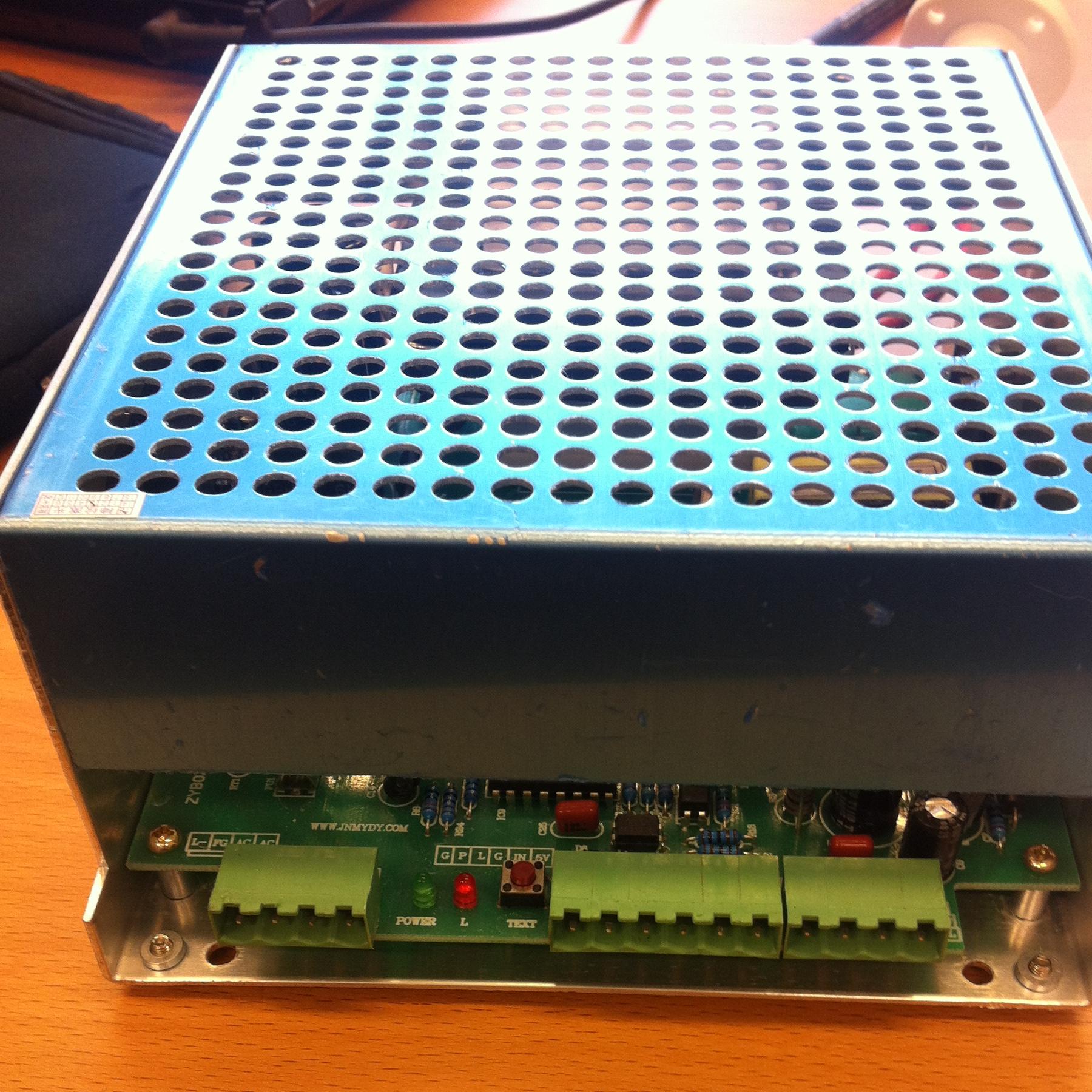

I recently purchased the DSP upgrade kit for my K40 C02 laser and cannot seem to find whether or not my laser power supply needs to be replaced.
I know that my power supply needs to be PWM capable, but i cannot find any information about whether it is or not. The power supply i have is a MYJG40W and its serial number is: 4013010216. In the tutorial on this website there is a very different power supply in the pictures and was wondering if there was a tutorial for the power supply i have, if it is PWM capable. Also As far as connections go, the schematic i have lists a TTL connection from the laser controller which goes to a TL connection on the PSU. My question is, is the L on my PSU the same as the TL in the schematic?

Here is a picture of the connections.<br />I've noticed that it has all of the connections except TH, it has a second Ground instead.

Must have "TTL", and "PWM" input
The one you have doesn't look like it is a PWM power supply. It may work but the result won't be as good as a PWM power supply
Plus, you need to be caution on the connection.

Thats the same PS as mine, i haven't upgraded mine to DSP yet but i know of another conversion board that is able to control this PSU via PWM.
