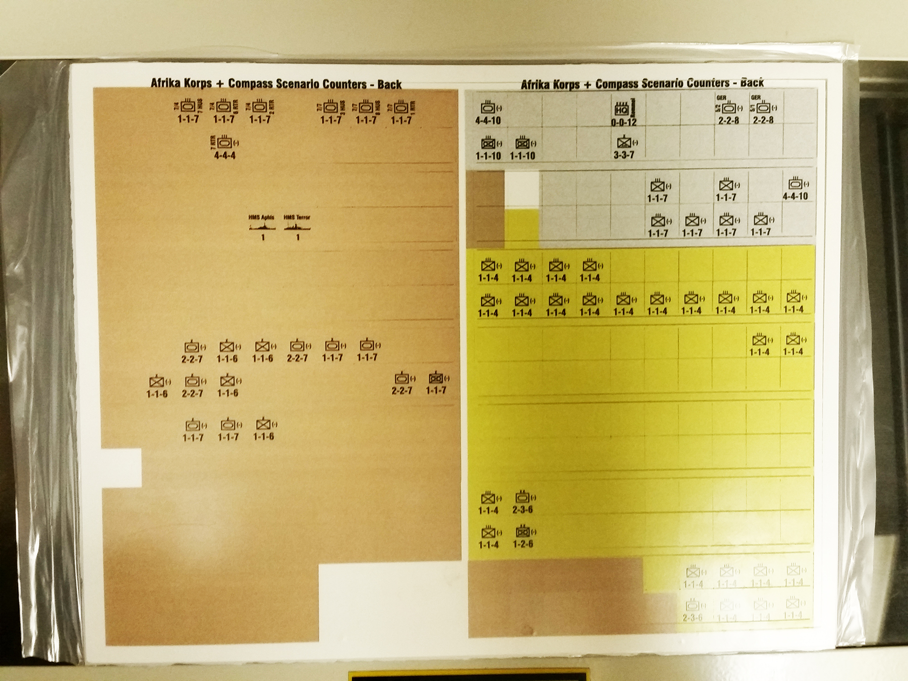

Sorry, that's MA. The 35 power setting was for PPI on, actually used 19 with it off to get the reading under 15MA.
I checked the bed and it seems to be the same distance from the focusing lens in upper left and lower right - right at 2 inches.
Focusing lens appeared fogged. Cleaned it and noticed a tiny spot on it that would not clean off. Need to replace it.
The cutting beam seems consistent with the spotting light across the sheet. I did raise the bed about 1mm and ran a couple tests.
This image attached is at 17min, 18max power, PPI off, 2 passes 13mm/sec.
The problem remains about the same as it was before, even with a cleaner focusing lens. I suppose that small spot could be throwing it off.
Cut job starts at 14.2MA and ends at 13.9MA after 24 minutes. Adding a 3rd pass would cut the sheet completely but adds another 12 minutes to the time.
24 minutes per sheet is tolerable but 36 is not. Would lowering the bed be better than raising it? I really don't want to replace the mirrors yet - they seem fine.
