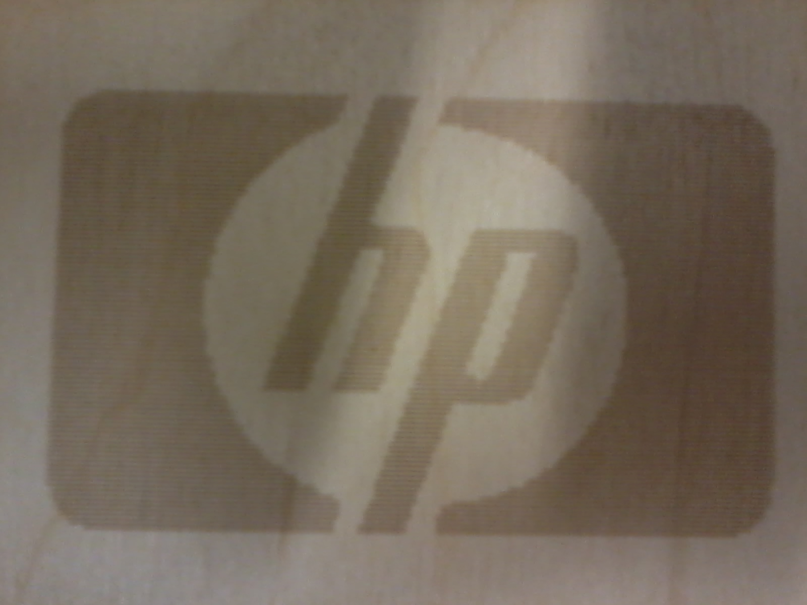

I've got a problem. I've tried to engrave a square 20x20 but it doesn't have desired size. Its size is 34x34.
Here's my setting of axis X Microstep Driver M415B.
SW1- OFF,SW2 - OFF,SW3 - ON = 0,63 A
SW4 - ON, SW5- ON, SW6 - OFF = 16 MSTEP
Here's my setting of axis Y Microstep Driver M415B.
SW1 - OFF, SW2 - NO, SW3 - OFF = 1.05A
I've been trying to engrave logo HP but it's bigger than it supposed to be and as you can see in the picture below there are lines which aren't supposed to be there.
