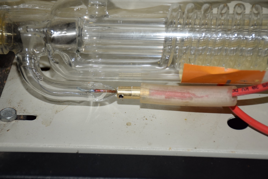

Preso
- Posts: 23
Re: Replacing 40w tubes...
This worked for me!
The HV cable in my machine had been soldered on by the manufacturer. After reading various posts about why this was a bad idea I carefully removed the solder which luckily had not bonded properly to the tungsten pin, I experimented with screw connectors. See this post viewtopic.php?f=47&t=2187
The brass connector I made was a little on the heavy side and the diameter was larger than the inside bore of the silicone air tubing which is most often used as an insulator around the connection. I made the barrel of the connector slightly shorter and just a fraction larger than the interior bore of the tube. When the 3mm socket head grub screw is fastened down I slid a short length of tube over it and the glass tube around the tungsten post. I did not add any silicone sealer and so far it has worked perfectly.

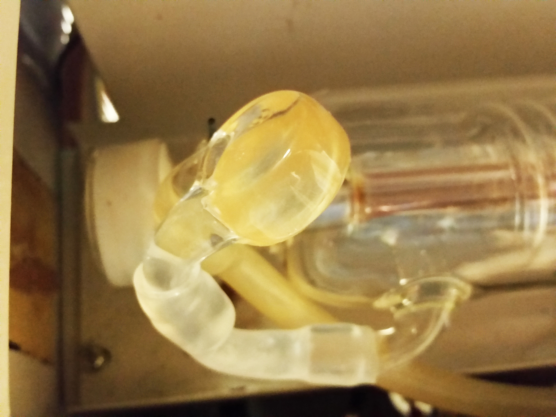

Craig_Johnson
- Posts: 43
I would love to have a set of connectors! but I don't 'make' parts like that.
I thought I would be able to jam the wires onto the posts, but after looking at the wire, that approach was not going to work.
I did the wrap around the post with a small zip-tie thing. I really felt that I didn't do a great job on it. The laser seems to work though, and I'm calibrating the settings I need to cut the parts I need. I did silicone the contact, its needed to prevent arcing. You should probably add some to your connectors.
I did have one problem though, when I was putting the rubber hose on the tube I herd a loud 'snap'. I didn't want to look, I already broke a tube last week. The end cap with the water tube inside snapped off. I hope it not a problem. I'm not confident with the results yet.
Most folks didn't pay attention when putting on the hose. You need to push the back of the other side to avoid the break of the connection. It's not the first time I heard that this thing happened. The other things to look at the HV pin. When one applied too much force on the pin, the pin could be cracked as it is very fragile. Don't try to hard but with gentle force. A zip-tie is prefect but you got to know how to 'force' to use. Before, I use cutter to do the job and now I use a cable tie gun.
