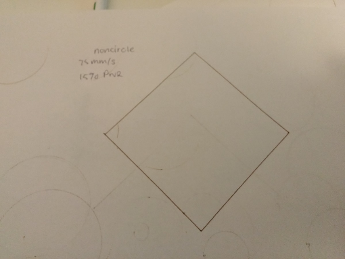

Just finished installing the AWC608 upgrade for the K40. When I tried to make cuts, however,I noticed that the endpoints did not connect--something more prominent when cutting circles. I tried searching the forum, but nothing seemed to quite match my problem.
So far I've tried adjusting the acceleration and speed, changing the edge settings, and changing the step length. None of that seems to have worked yet. Next step would be to check any mechanical issues causing this, as opposed to the software. Is there anything I'm missing?

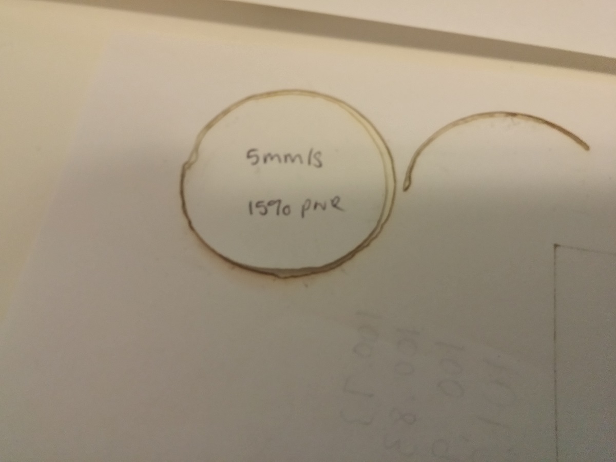

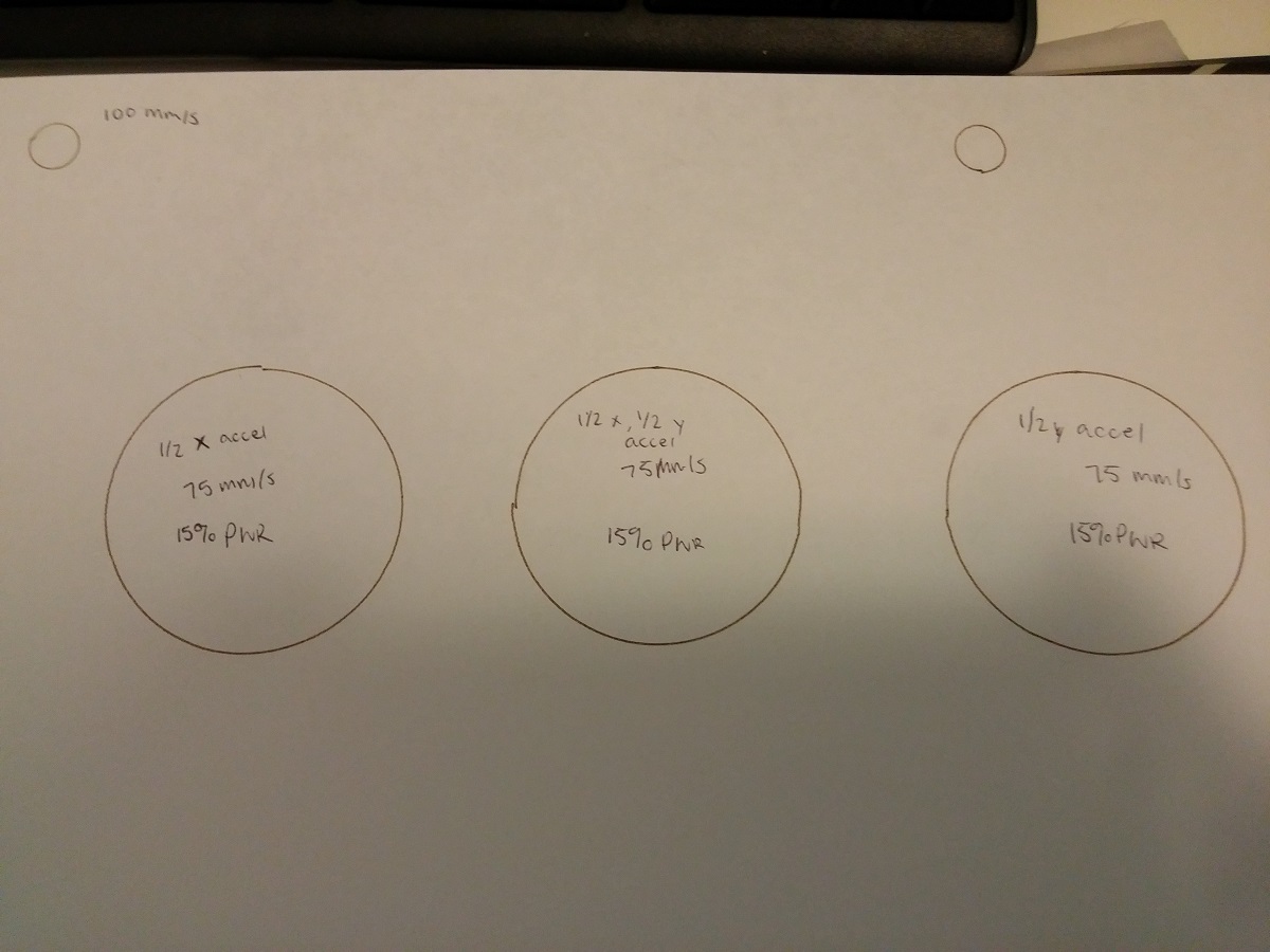

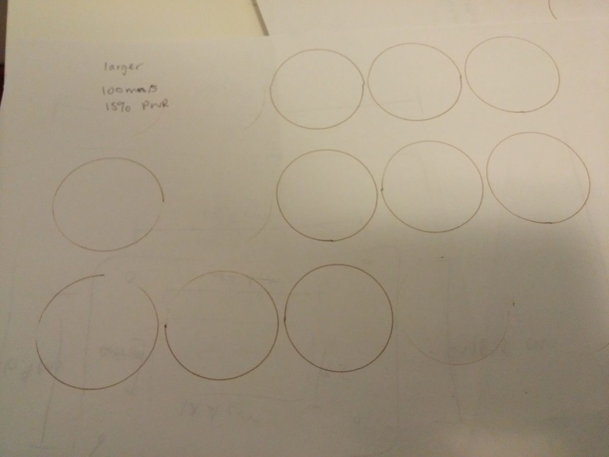

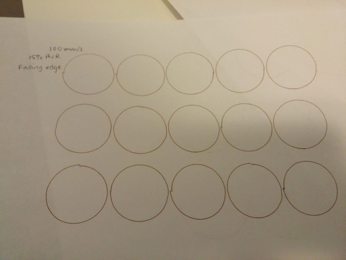

I attached a picture of some more tests. The particularly grotesque cut was done at a speed of 1mm/s; slightly less deep ones are 5 mm/s, then 15 mm/s then 45 mm/s.
