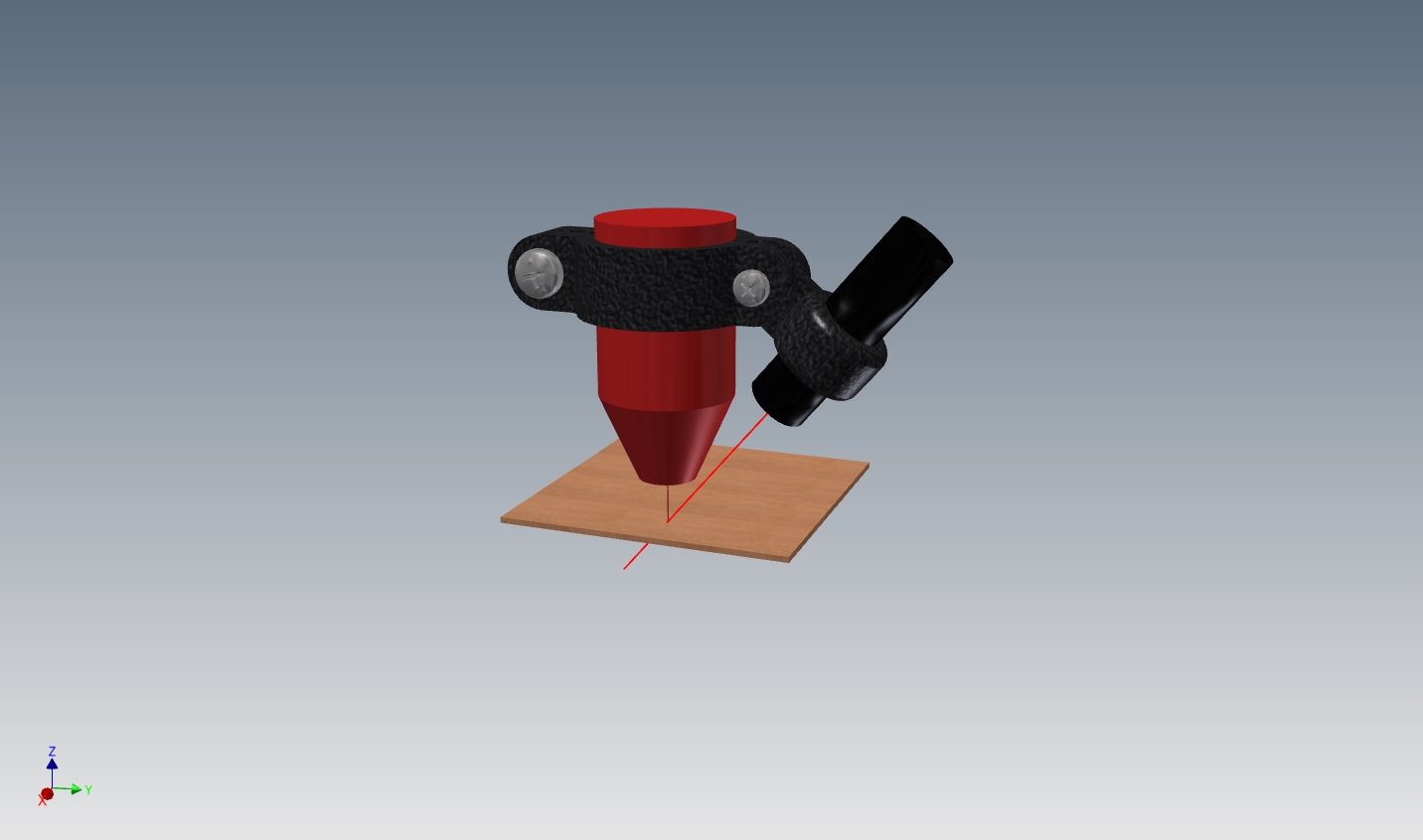

I was doing some reading on another forum and found out that the laser pointer of the type that I am using is case negative. This would explain why the laser pointer shorted out the 5V supply. Strange though that it only happened after I connected the digital ammeter. As it turns out I abandoned the idea of using a beam combiner lens. I will instead mount the laser directly to the air assist shroud. I have 3D printed some fittings in ABS plastic which angle the red laser beam at an angle of around 40 degrees to the vertical. This system also assists with focussing the main beam.

The first Chinese laser we had at my former school had a pointer setup like the one I have replicated. Initially I thought it was a fairly cheap and simplistic idea however it does have the advantage that it can be aimed so that when your focus distance is correct, the spot made by the pointer will be directly under the centre of the cutting beam. When I set mine up I set the focus distance with a piece of 8mm acrylic (that is my correct focus distance) and then burned a spot in a piece of wood. Then you only have to angle the red dot pointer to coincide with that spot. Tighten up the M3 screw to set the angle and the M4 screw can be used to rotate the collar around the air shroud so it is in a convenient position. The only down side is that the power supply to the pointer has to be threaded through the X and Y cable chains and then back to the electronics bay. No problem if you are building from scratch but a pain if you are retrofitting like I was.
Evidently, STL files and other CAD formats cannot be attached to this message but I will put the files for both parts up on Thingyverse if anyone wants to have a go. Here is the link http://www.thingiverse.com/thing:472793/#files
