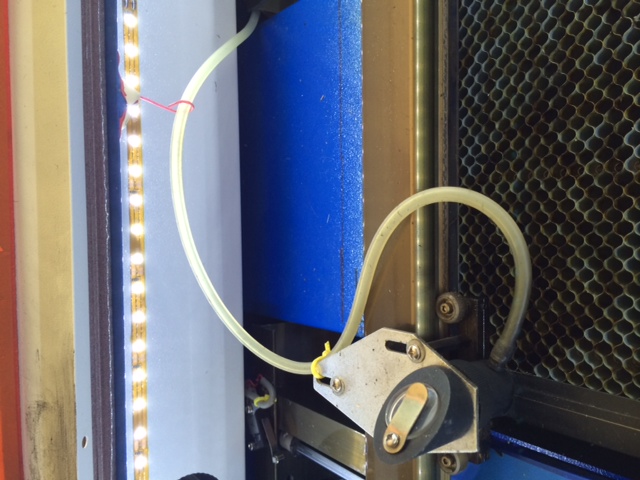

My air tubing for the nozzle is a length of silicone tube (very tough and flexible) that I got by sending off for a free sample! It runs over a paper-clip Sugru'd to the top (Google Sugru if you don't know it, it's a magical and extremely useful material).
It's done a good many hours completely trouble free.
I also have an 'air curtain' fed from the same airbrush compressor (which I'm thinking of upgrading) which sweeps all the shit from front back towards the exhaust ports so helping to prevent condensation on mirrors etc. Nick
