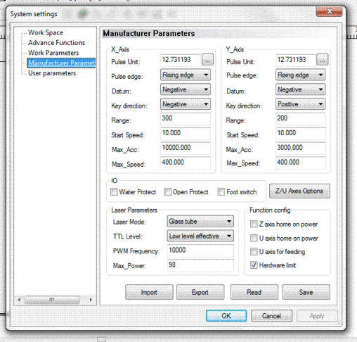

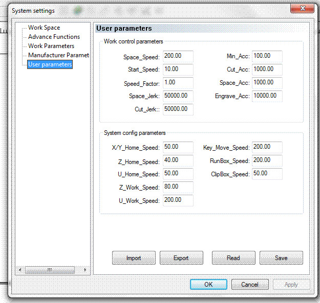

I have setup all the settings like here in laser cut 5.7 what I have downlaoded.
but the probleme is I could not even run the box or the clip box it always comes the message on the display "behond size"
I even have set the size to much smaller x=150 and Y=100 but the machie does not recognize it
now can somebody help me out and maybe send me the screen shots of there machine or has some advice

You're probably just placing the job outside of the table, are you using soft location or panel location? I´m guessing you´re using panel location and your origin is set incorrectly, try moving it, also check where the origin of the workpiece is set, it can be set to upper left, upper right, lower left, lower right corner, or center. If you, for example, use the upper left corner as the origin of the workpiece, but place the origin of your machine in the lower left corner of the table, then your piece its located out of the table, I don`t know if I´m being clear about this, my english is not THAT good.
. You could also switch to soft location, that way the piece is going to be cut exactly where its located on the screen. Again sorry if this is confusing, hope I could help
