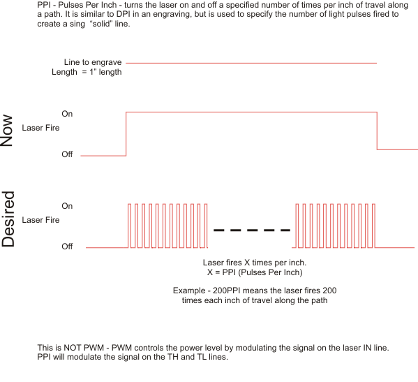

Some other commercial laser have the ability to set a pulse rate when cutting. This is usually talking about in terms of Pulses Per Inch (PPI). This would mean instead of turning the laser on and leaving it on the laser would be fired that many times per inch. For example if my machine was stepping at 1000 steps per inch and I set a cut job to 200 PPI the laser would fire every fifth step instead of just turning the laser on and stepping. This allows for much greater control of heat put into a material.
Ideally this would be another cut parameter we could set along with power and speed under the layers properties.

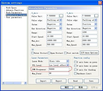

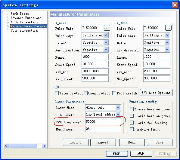

Craig, per programmer, he said that the PWM frequency is desgined for that purpose. You may give a try

I don't think they do the same thing. It was my understanding that the PWM Frequency affected the PWM that is used for the Input pin of the laser. This changes the speed of the square wave generated for setting laser power. This is not varied per material it is set once to a compatible setting for your power supply.
I'm asking for a similar control of the TH/TL pin outputs during a cut job. It makes cutting look closer to engraving where I don't bring the TH/TL pins to on setting and leave it there while I move the X/Y Axis. Instead I turn the laser on and off while the X/Y Axis moves. For a PPI of 200 the TL pin would be brought low once every .005 inches of movement in the X/Y plane.

I second the desire for a PPI functionality. The ability to set the number of laser pulses to the TH/TL pins per unit of distance traveled would be very useful.

I ran tests this weekend. Varying the PWM frequency on glass tubes does not have any affect. Also, on the 2011 model, the minimum frequency is 5000. To do the kind of work the PPI does for you, you need to be about to get down to 200 and up.Tech_Marco wrote:Craig, per programmer, he said that the PWM frequency is desgined for that purpose. You may give a try

Here is a drawing that should help to understand what is needed. The idea is to modulate (pulse) the TH and TL lines at a specified frequency.

I just talked to the programmer and he said that he could add this function to the LaserCad. But he was wondering what's advantage to have PPI included? In what suitation is the PPI most significant? What is the densitty of the PPI wanted? He want to understand it completely before adding this new feature to the card. Both software and hardware need to updated (through patch)
Please response to me asap as he is waiting for my reply for the feature.
