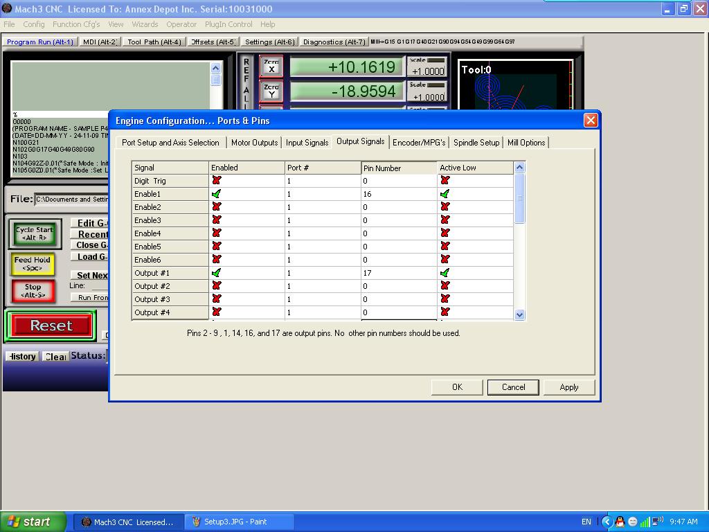

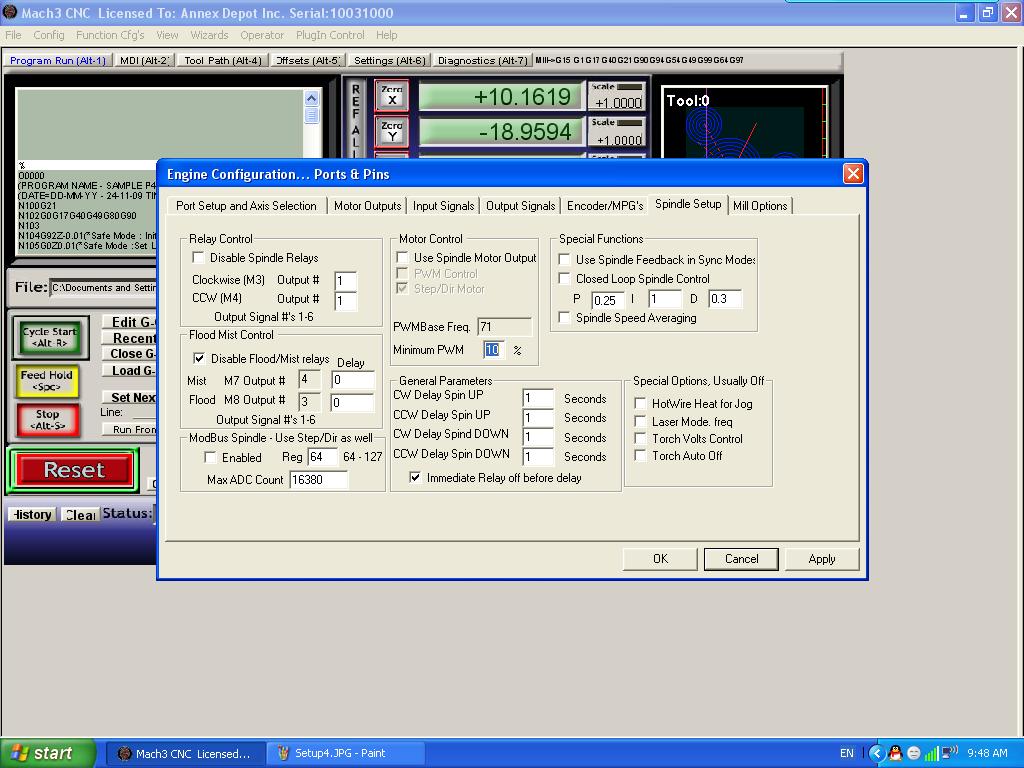

OMG,... the relay, as I mentioned, is a "Safety guard". I also mentioned that you don't have to but it's dangerous without it. Do you know that if you hit Up and Dn arrow key on the keyboard, or if you forgot to change the stage of the Z direction, the laser FIRE~~~~~~~~~~~~~~~~~~~!
But, with the relay is employed, fire can only happen if the X,Y is moving and Z is changing stage from + to - or from - to +, it serves as a layer of security lock to avoid fire accidentialy. It's kind of protecting kids or other people around the machine who always curious this button or that button is.
You need to enable 'Relay' on Mach3 setup.
Now you guys own me another lunch

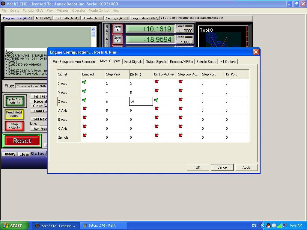

It's too earlier to say the board is defective. In fact, if you understand Mach3, you don't even need to use the board for fireing the laser. All it need is DIR signal from Z! In fact, what you need is - patience. The first time when I tried this 3 axis board, I even didn't know what is Mach3 and I really didn't know how to drive a 3 axis card by Mach3. Moreover, I didn't understand G-code either. But I taught myself a little by little with logical thinking, do it step by step and asked why and why not. All I learned was from "test and try".
On Mach3, the most confusing part is the Enable Low or Enable High. It really mess things up easily. Again, do test and try to understand it. When I tried PWM controlling on Mach3, I spend 4~5 nights just by trying each 'check box' on Mach3.
By the way if you know Mach3 well, then you know that for a 3 axis or 4 axis board, the X,Y,Z,A really means nothing as you can assign the pin# and port to each axis. So, if you want to know if the board is defecive, well it's simple to get the answer: just swap X or Y axis with the Z and test again if the X-Y moving correctly. If it works ,then there is nothing wrong with the board, agreed ? Remember, a 3 axis board is equvilant to three 1-axis board that being put together, then label X,Y,Z... But can't I say " Y,Z,U,X. Yes or no, it depends on the Mach3 setup.
Remember what I said, to simulate the FIRE, you use the DIR signal from Z axis as it change polarity +/- during the up and down movement. When it's down (CNC machine), it send out a pulse signal (I assume +) and use it to trigger the power supply. When the Z withdraw, the + become "0V" and it shutdown the FIRE.
How to test whether the DIR is working. Simple, use a scope or a DVM (digital volt meter) to check the voltage level appear to a specific pin which I believe is #7, the DIR of Z (note: in Mach3, #2,#3 is for X, #4,#5 for Y, #6,#7 for Z in general). All these pin are acutally referring to the pins of the parallel port on the computer. The # 7 is actually the pin#7 on the parallel port. So, if you're not using the I/O from the board, you still can test the FIRE by getting signal from pin#7 from the pareallel port. I did that and it worked the same. But why would I want to use the I/O instead. The resson is: an isolation protection to avoid direct contact to the PC. My board used high speed optical coupling IC while those cheap board on eBay are using low speed. That made the difference vs the performance.
If you have a scope, you can see better and make your life easlier. But a DVM is OK
To test whether the relay is working or not, it is more simpler by using your ear. When it's energized, you should hear the 'click' sound when it latched. Things you need to be paying attention: BIOS setting on PC must be have the parallel port enabled. Parallel cable must be Bi-directional but not the dump-modem cable (serial cable 4 wires). Check all pins by using a ohm meter. Makie sure #1 to #1... #25 to #25 pair to pair.
If you can get the signal from the DIR (Z), the 5V TTL should be good enough to drive the laser power supply by connecting it to the level high port (TH). Make sure your laser power supply is enable with "Water protection" ground. Once a positive + signal sent to the TH, it should fire

A stupid mistake cost me 5 hrs sleeping time last night
Now, it works like a champ!
TA8435 and TB6560 made no difference.
Pin7 port was replaced by Pin14 as I have I/O port for Pin1,Pin14,Pin16, and Pin17. You can do Pin7 but you need do soldering a wire to that.

Re: TB6560 Configuration for CO2 laser - firing trigger
Hi there Marco.
I just gave it a try and it worked perfectly. I was able to map pin #7 to pin #14 on the output port and reset the conditions in MACH as outlined in your response.
Now all I have to do is put it all back inside the box and start burning stuff.....

If you can toggle it for 5V and 0V but got nothing when machine is running. Chance is that you're not using my sample code where "Z" value was set. If you don't have "Z" setup right, there is no "Z" action, means that there is no "fire" action.
If you're using my board, the pin17 is relay. I have enable "Output1" for pin17. If you have my board and my sample code. You need to follow "exact" what I posted those screen shot. Don't oversight or miss "Any" step as each setting is important. That's why it cost me days and days and nights and nights to make it work.
Also, did you use my sample code?
