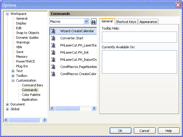

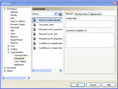

I am in the process of installing the 2010 DSP controller in a 40W Chinese laser. According to the Setup Guide when I launch Corel for the second time I am supposed to go to Tools Menu/Customization and from the Macros list drag the "Laser.User.Init" out of the dialog box. Unfortunately I do not have that list on the Macro list (see screen shot). Can anyone help me?

I'm pretty sure you can drag the PHLaserCut.ini out and it will do the trick. It's been a long time since I've done this but I think that will work.

I can not thank you enough. It worked great.
