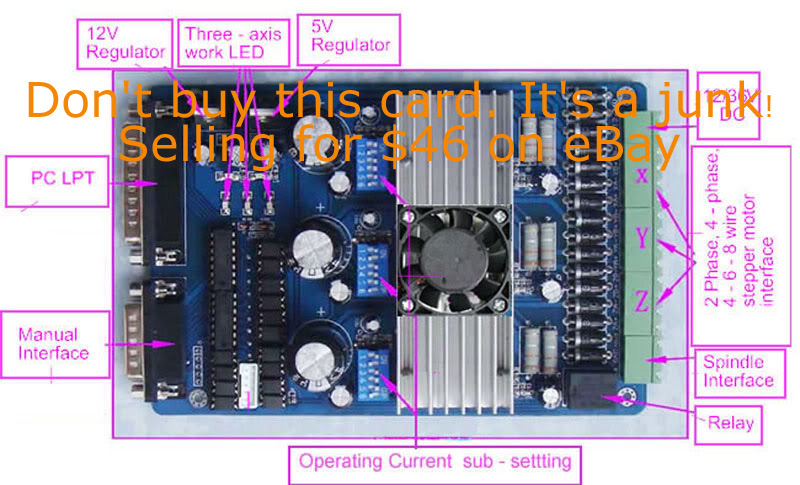

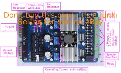

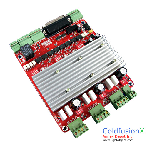

Re: Installing a TB6560 board controller on a K40 laser mach
FYI, see attached image for comparsion, the blue one is 'junk' and our 3 axis (red pcb)
