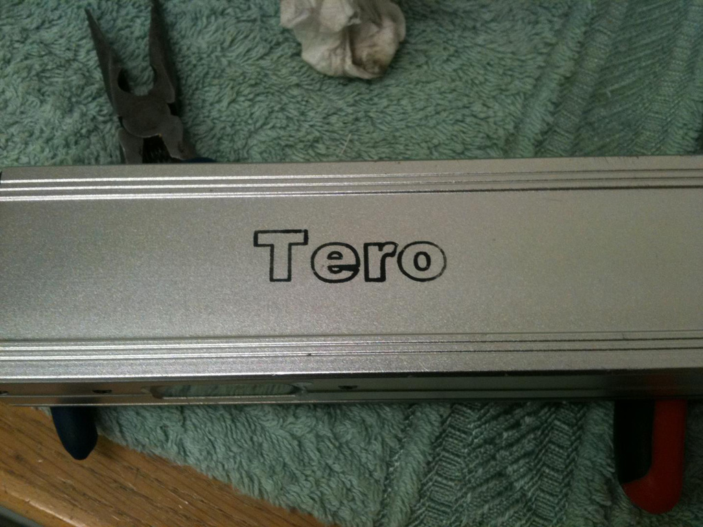

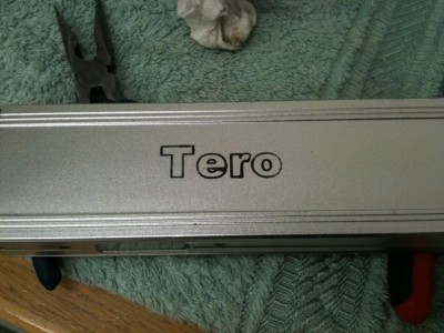

Anyone try laser to aluminium? i try but i put first laser printer ink light sheet over aluminum and then burn it's actually work
but where people buy real stuff? tape or that paint
