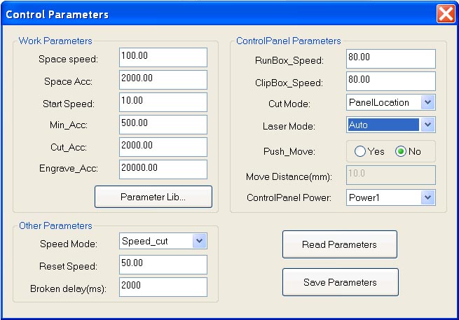

Hello,
Everything is working fine in my board, except that I can't change acceleration settings in manufacturer parameters.
That is, any value I change and upload to the board, it is the same slow accel. in the machine.
I am using PHCad 4.45.
Pulse unit: 16.08
Start Speed 40
Max Accel: 50 -No matter which value I set here, it is the same. Say 50 or 5000.
Max Speed 1000.
Any idea on what I am doing wrong?
Daniel

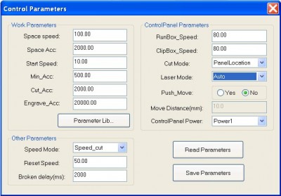

Re: Acceleration Settings
try this dialogue. I think it can be found on the right under the 'machine settings' dialogue box.
