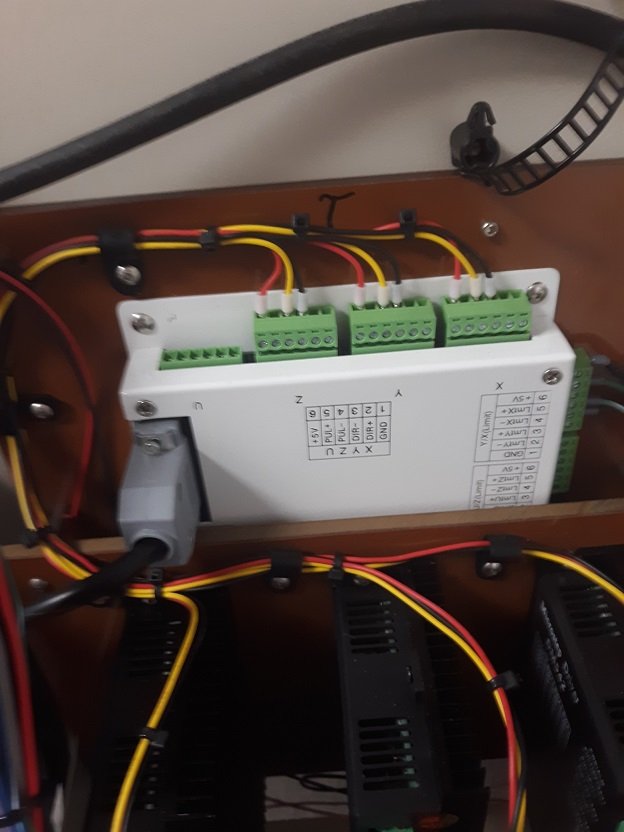

I just upgraded and old ULS-25 Laser with the T9 DSP and all is working well. However the jog keys on the control panel does not move the steppers nor can I get it to move with the software, I have added the Z stepper also and it will not jog, I am using the Omron optical limit switches on X and Y just needed to change the limit signal to Active high and they are working great, however before setting up the limit switches the X Y and Z worked fine? any ideas?
Re: T9 Jog not working

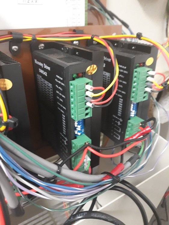

How about running a cut or framing, does anything move? Are DIR and PUL connected correctly? Could you show some pictures?

I am able to vector and raster and it returns to home, I have adjusted the um and the size is correct, I will double check the wiring for the DIR and PUL and send pictures in the morning

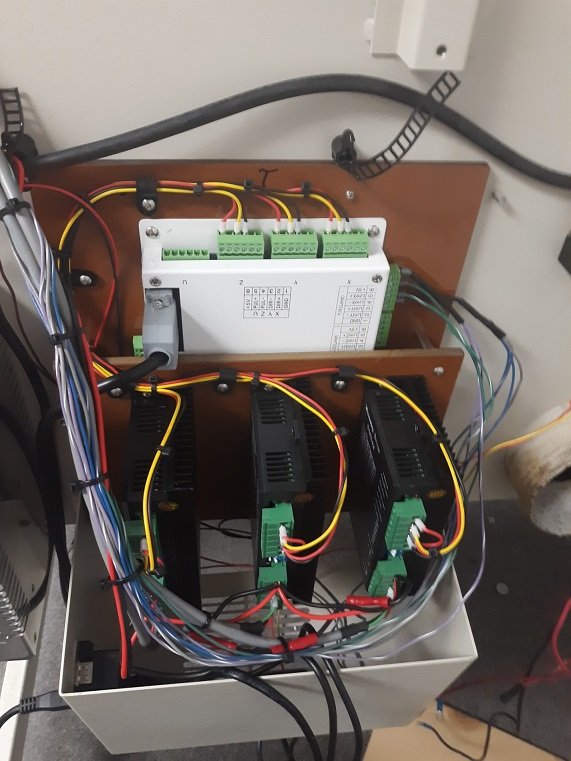

Here are the pictures, let me know if you need other pictures, I am thinking about adding the mechanical Micro switches to see if that is the issue

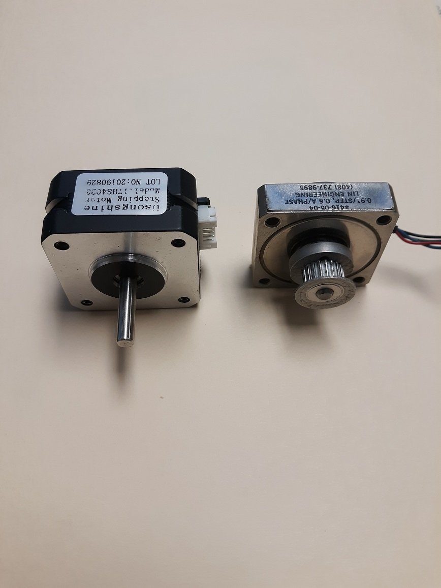

Hello today we started running a job and about halfway through the X-axis stopped working, there is a red and green light on the stepper driver. I changed out the driver for a new one same red and green light, if I unplug the wires from the controller the light goes out, got any Ideas?

i found the problem It was the 24 year old steeper motor that went out it's a very small pancake motor, I had the current set as low as it can go I just think it was to much for it. Picture attached new motor on left
