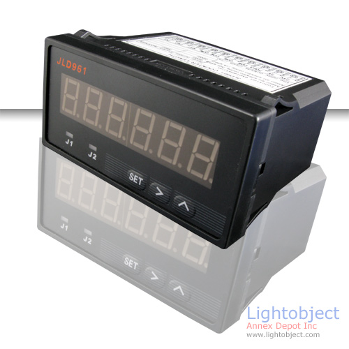

See this counter. It's a 6 digit counter and I need do some study to see how it works. What I think so far is that, you hookup the water-flow sensor (5V pulse output) to the counter's Input and do a measure on how much water in a bucket, then use that volume to compare the number of counting on the controller. That way you can come up a simple formula: Counts vs. volume.

The flow element has a calibrated pulse rate indicated on the data (pules per litre) so test might not be necessary.
Does the controller have output switches like the JLD 7100? Do you have these already?
Re: Using EWP-SNR108 for low flow trip
Yes, I do have 20 in stock. I'll post it on the web soon
