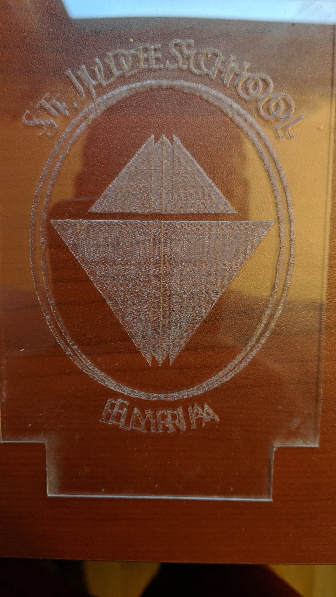

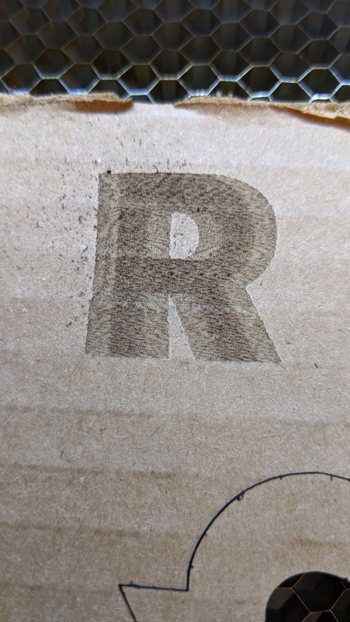

Hey Marco, I'm pretty sure it isn't any of those things. I've made sure they are all clean and not damaged as far as lenses and mirrors. This only happens when the head moves towards the stepper motor driving the X axis. I've attached a picture of an acrylic piece that I made this week using the X_Swing method of engraving. You can see how there are two accurate but shifted images that should be lined up when engraving together.

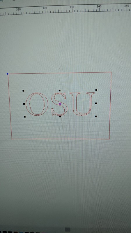

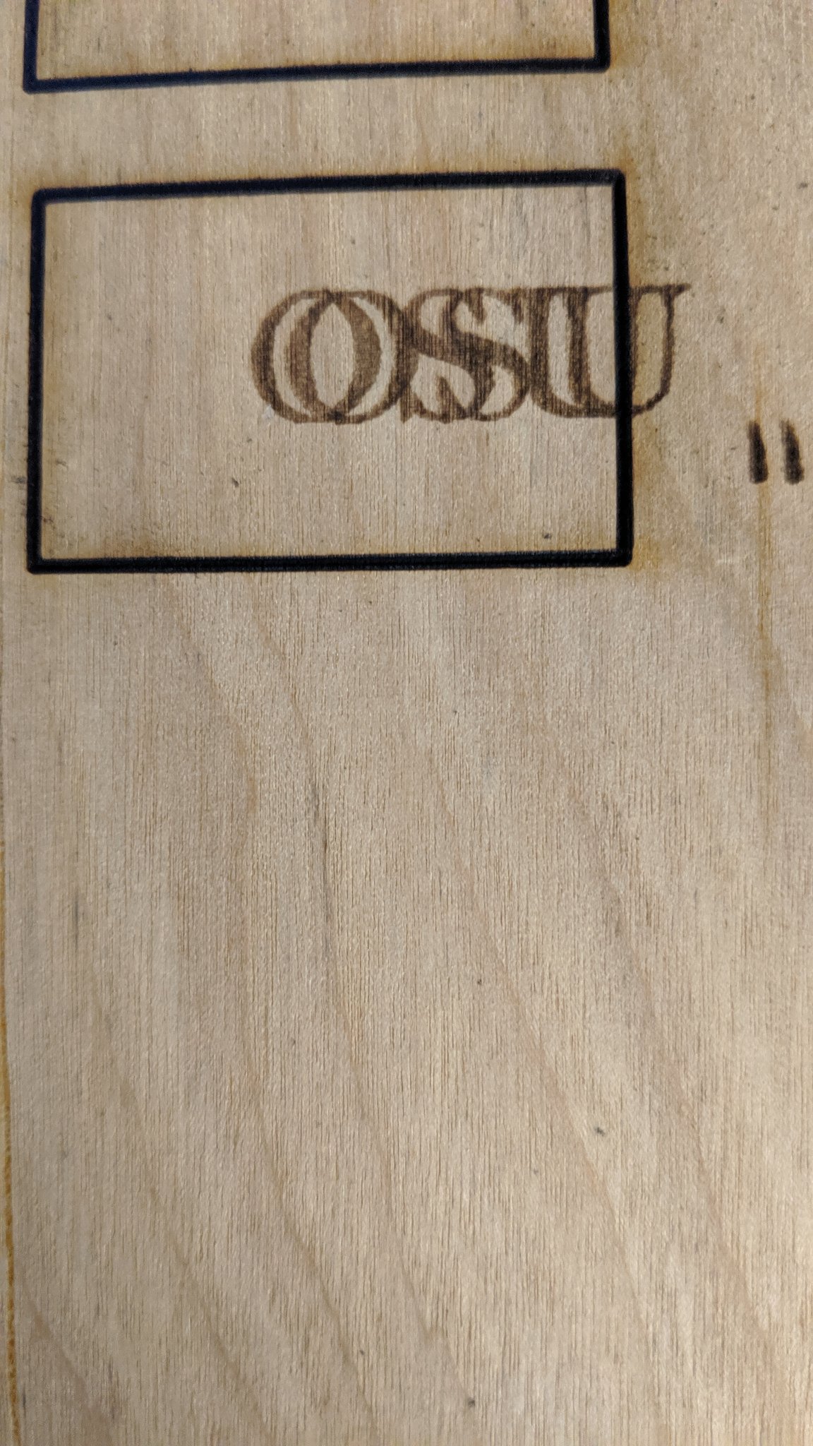

Here are two more pictures. One with what it's supposed to look like on the PC and what it actually does. This was supposed to be an engrave then cut Operation.

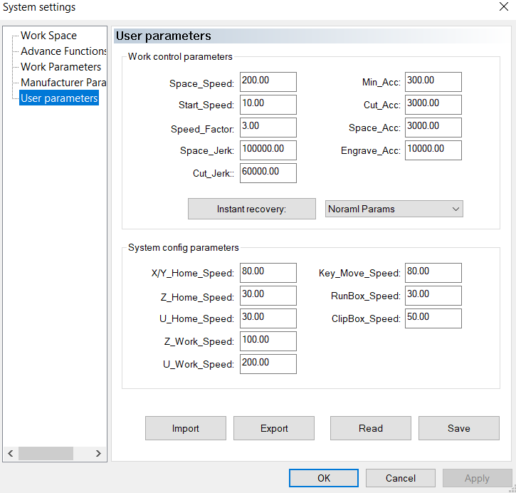

Here are some screenshots of the settings in the laser. For the examples I have already provided I ran at 250mm/s for the engraving. I've never actually tried running an engraving at a slower speed than 200mm/s because it's really slow then but I may have to see if that makes a difference.

Re: Double image
Try this:
Space_jerk to 40,000
Cut_jerk: 25,000
Speed factor: 1.5
Also, cut a square 50mm x 50mm with low power, say Max: 12%, Min10% , speed: 100mm/s. Post screenshot here

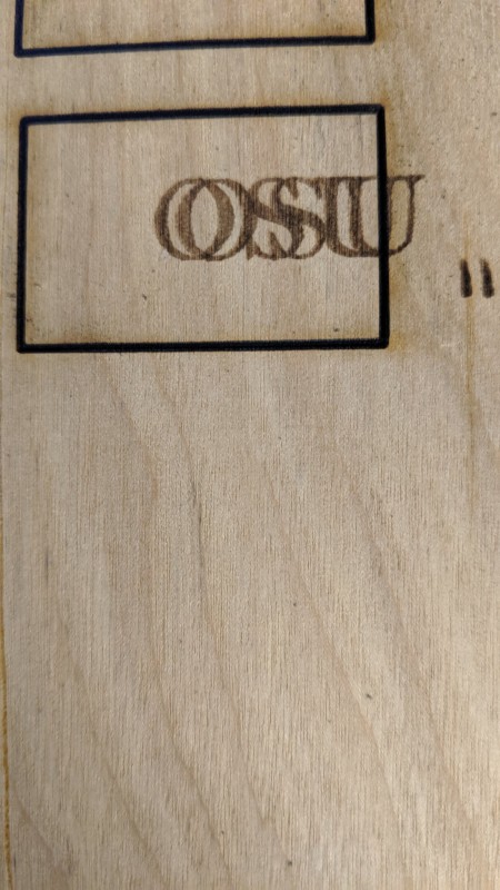

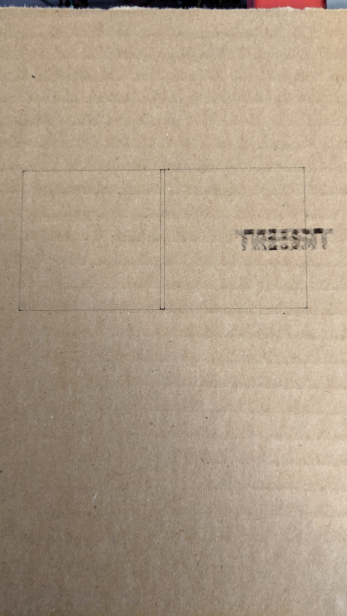

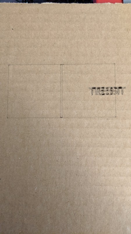

OK Marco, Here are the results on cardboard. I did the box as requested first on the left. It measured exactly 50mm x 50mm. Then I did an engrave and cut function on the right which shifted again as you can see the two squares are overlapped and they shouldn't have been. The text has also been moved to the right of the box it cut.

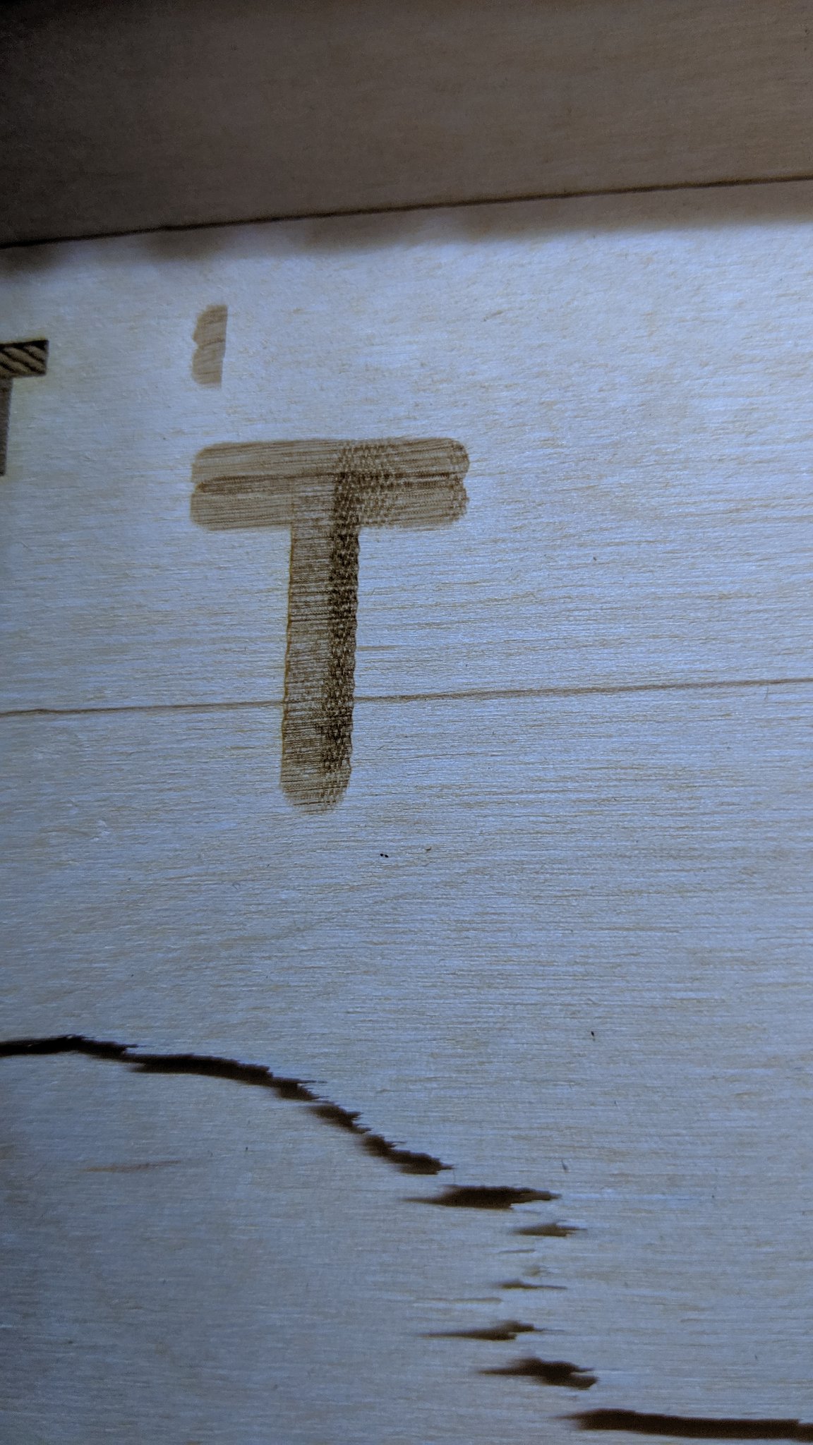

Alright Marco, First thanks for taking the time to help me. Second, Here is a test "T" going in the Y direction. As you can see the error is exactly the same but now it's verticle and of by about the same amount when doing an X engrave. For the heck of it I tried using the Lightburn trial software to see if it made a difference and it doesn't affect anything at all. Even slowing down the engraving still causes the issue to continue by the same degree.
I actually was able to engrave then cut something out by engraing first, then moving the laser head 3 spots (1.5mm) to the right (I think I have the nudge set to .5 mm). Then I sent the cut file to the laser and executed that program and it cut the engraving out perfectly. I Just wish I could figure out how to do this in one program by getting rid of this double image.

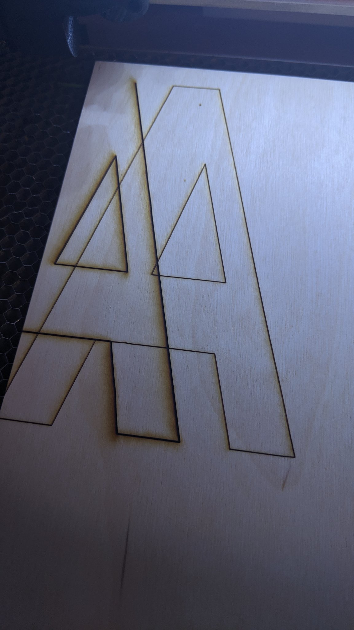

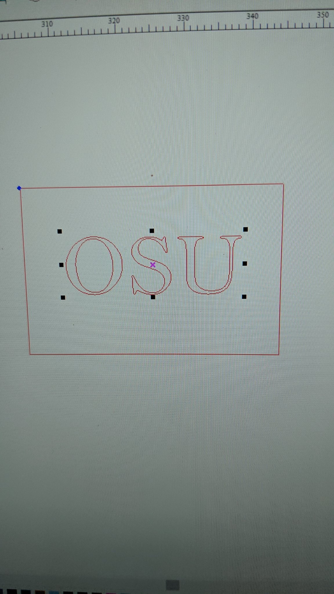

I'm so frustrated at this point. I'm am completely out of ideas and getting to the point that I feel I've wasted time and money buildling this laser because I cannot get a good control over it. It is almost like the laser forgets where it is as the head is moving. I am working on cutting out letters, one at a time. A simple task for any laser and it can't even cut the letters correctly. It starts cutting outside of where it is supposed to then for letters like A with a center it cuts out the center and outside are out of alignment! I'll attach a picture to show it but this all has to be related.
Re: Double image
It is just a simple setting you didn't check. You just need to check "Re-order Object" and select "Inner to Outer" when you do download

Re: Double image

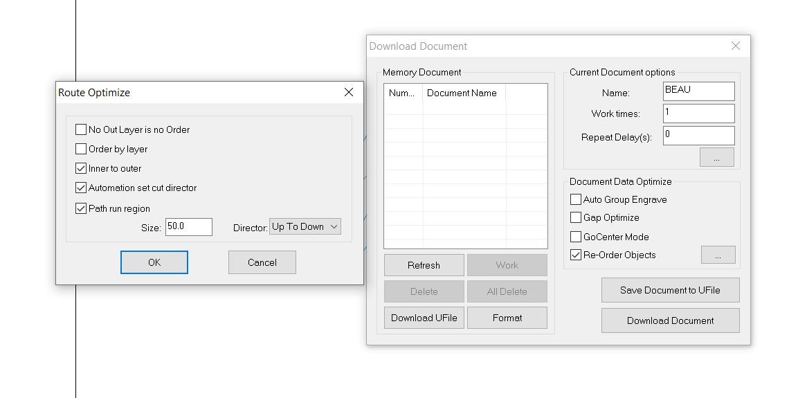

Hey Marco, that option has been checked this whole time. I double checked everything to make sure I didn't accidentally unselect it. That is selected, inner to outer is selected, automation set cut director is checked and path run region size: 50 is checked.

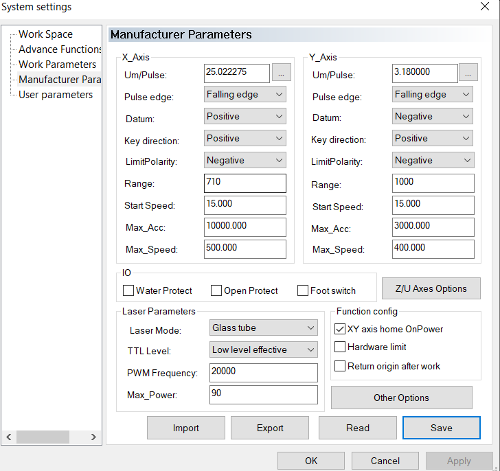

Hi Marco, Just for the record I don't mind a project but my lack of programming background makes something like this difficult to figure out where to go when the laser isn't acting as expected. I was under the impression that having a controller like the x7 would simplify the process. I just need help to figure out what to do to fix this issue, I think it is all related.
It's like the machine isn't keeping correct track of where the laser head is, the more it moves the further off the machine gets. It happens allot where I can move the head around to test things and somehow it loses track of where it's zero is, I will try and run the head to the farthest up and left point on the machine where the mechanical switches and it stops before it gets there as if the machine thinks that it is already at it's home point but it isn't. I'm wondering if the Stepper motors are bad, is that possible? They don't get hot and they run the machine.
As far as the screenshot I attached it, I'm hoping that is what you were looking for.
