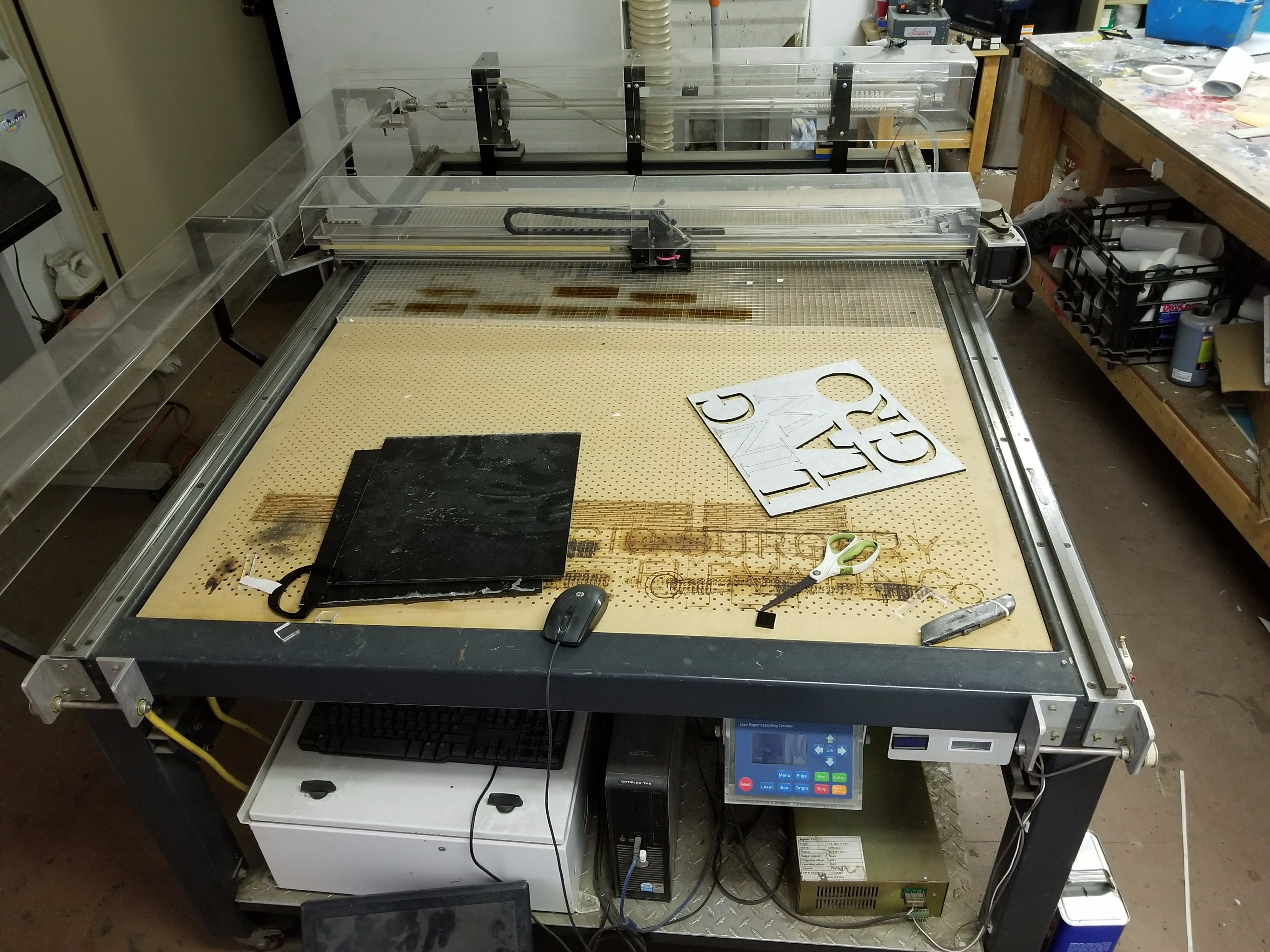

So I was told putting a beam expander on my table would be a benefit. I was hoping someone could give me some insight as to which size would be appropriate. My table is ~4’x5’ with the 100 watt RECI laser at the back end of the table. The spot size coming out of the laser I believe is 8mm for the 100watt RECI. The 2 mirrors that bounce the laser to the cutting head are 25mm and the mirror inside the laser cutting head attachment is 30mm. (It's the SPECIAL PRO HEAD LASER MOUNT) The focal lenth of the lens is 50.8mm and the beam hole where the laser enters the cutting head says it’s 20.25mm, but it’s closer to 23mm. Curious if anyone has a recommendation as to what size beam expander would work for my machine?? I have attached a picture of the machine as well if that helps.

Hi Marco.. Thank you. New toys are fun. Sorry I didn't mean to make it seem like I was impatient. I figured I would throw it out to the forum as well as it might help someone else one day. My mirrors before the cutting head are 25mm (the SPECIAL LASER HEAD has the 30mm mirror), so I may have to get the 30mm mirrors if I want to go with the 2x beam expander I imagine. I think the 25mm mirrors would be okay for the 1.5x?? Do you think I would notice much difference from the 1.5 to the 2.0 in terms of power gain?
