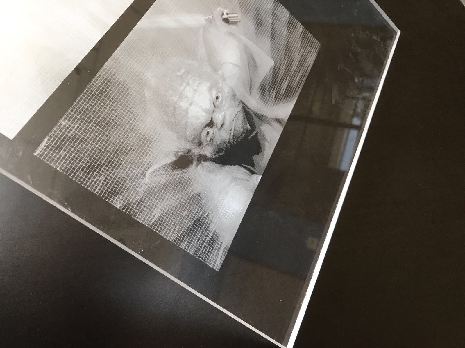

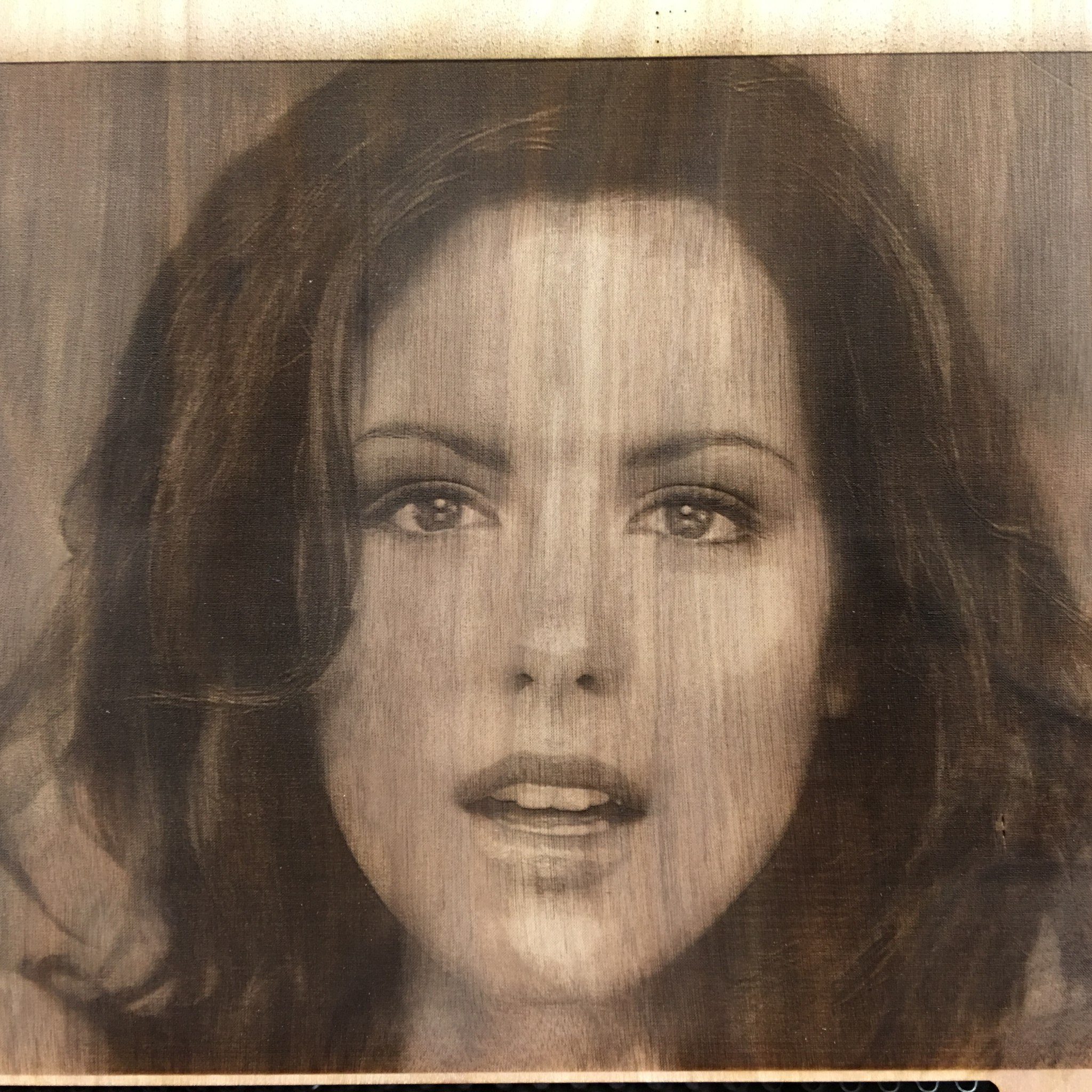

We have doing some tests on the T9 and currently is working on the video as well.
Following are two engraved images were coming out from default setting: dither:0.2mm, scan gap:0.1mm, speed:500mm/s, power(60W): 12%
Materials: Transparent acrylic + dark sheet background on reversed image Materials: Birch wood from HomeDepot (not a good one because so many texture from the wood)
Will post more for fine tuning engraving and cutting soon! Will do rotary engraving as well with easy to use keypad.

ok, so I tried to get the yoda etched as shown above.
0.2mm dither
.1 scan gap.
50% power , doesn't seem to matter if this is lower.
I also tried inverting the image.(shift I). But this will make a negative of the image which is not what I want.
See my attempt.
I used the same image as the above. https://www.bing.com/images/search?view ... ajaxhist=0
Here is how mine came out. Cant tell what it is. Can you tell me what I'm doing wrong? Id like to use my machine to do this kind of work.
https://drive.google.com/open?id=0B4K17 ... kR1UzFqbHM
Settings
https://drive.google.com/open?id=0B4K17 ... 1dqWXV2ZHc
0.2mm dither
.1 scan gap.
See my attempt.
Settings
Re: Samples from T9 DSP controller
I think my guy used 11-12% power on a 60W laser machine . Speed was 500mm/s. To see the image better, you put a black board behind the acrylic. Focus must be right and there bed must bed level and flat.
